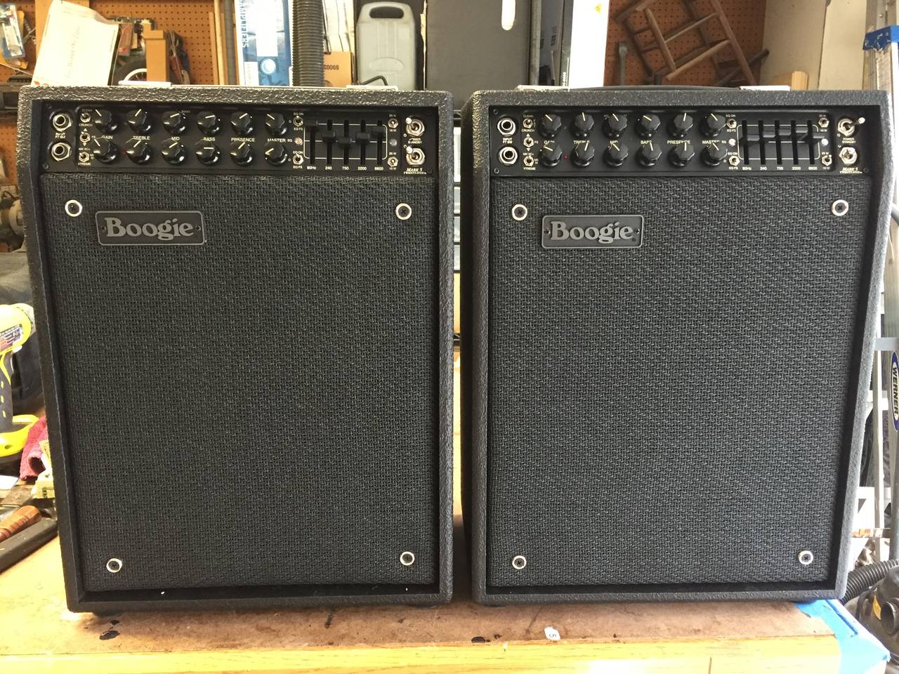

I built my Boogie Mark 5:25 into a combo with a single 12 that's only 15 inches wide and about 20 inches tall.....looks like a toy.....but screams.... :mrgreen:
In fact, I built one for another guy in my band too......baby Boogies....

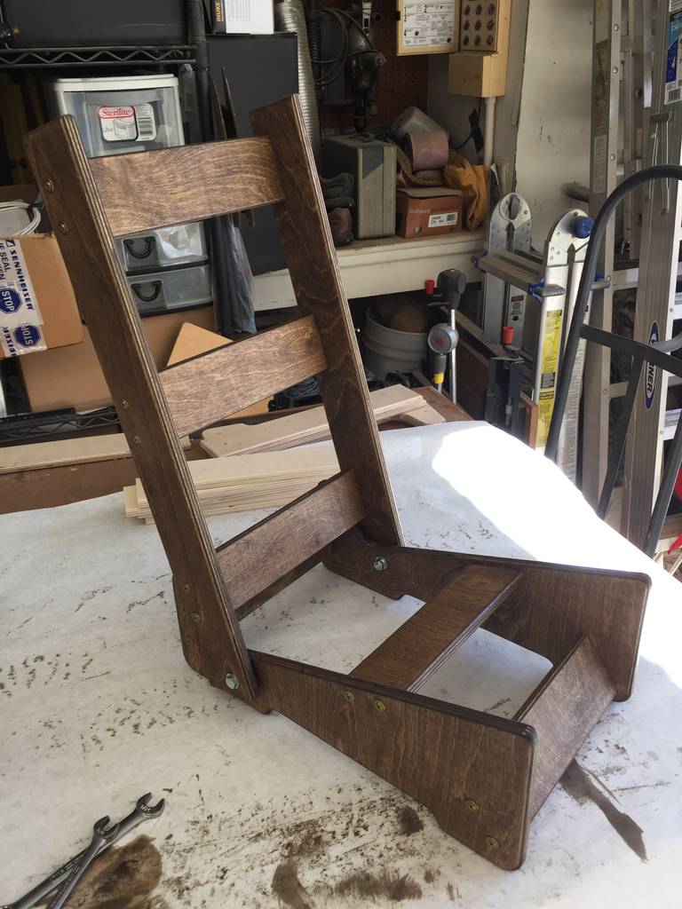

I built an amp stand to hear mine better.....It looks much better than the tall metal stands.
