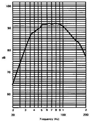

Looking at the response curve you posted...
and comparing it to a 24 inch T48...
Your current sub/24" T48
At 40Hz, 88/97
45Hz, 89.5/98
50Hz, 91.5/99
60Hz, 91.5/104
70Hz, 92/106
80Hz, 92/107
90Hz, 91.5/108
100Hz, 91/108
Average, 91.8/103.4
A single 24" T48 will play as loud as all 4 of your current subs on roughly 1/4 the power. If you could manage a 36" wide cab (I'd put casters on the side instead of the back) you'd gain another 3dB average sensitivity, meaning you could match your current output with 1/8th the power you currently need.
