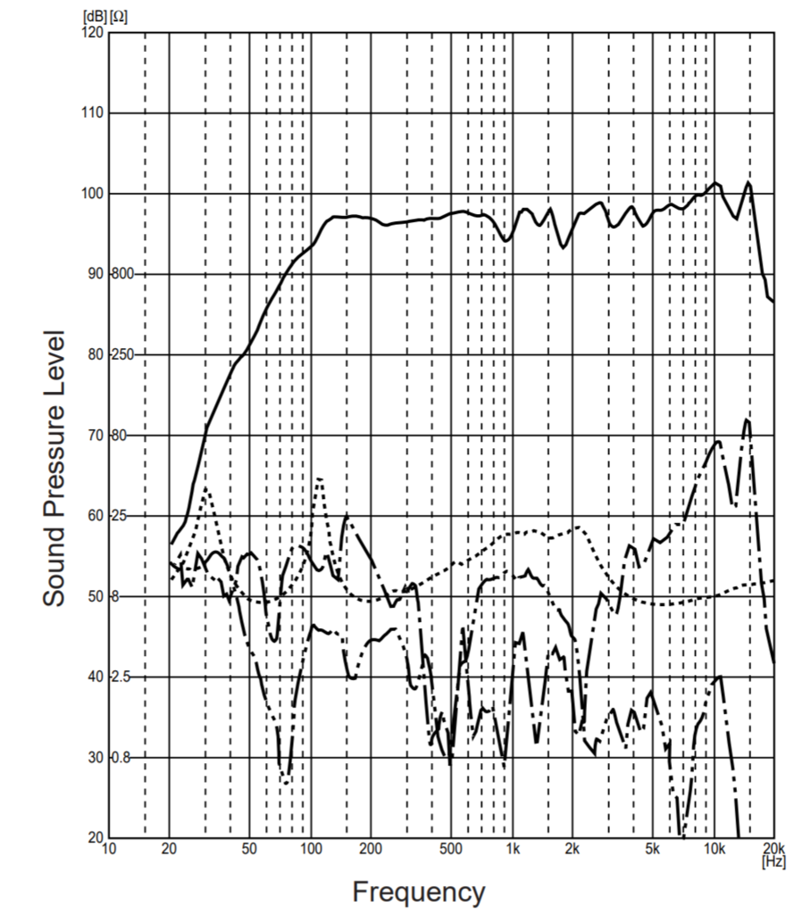

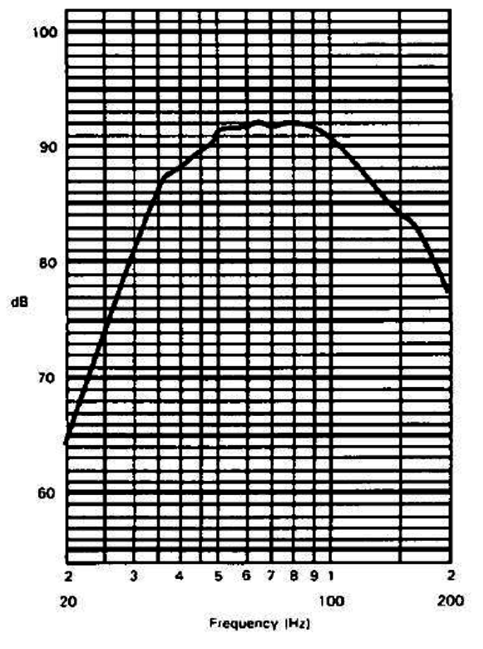

I'm not exactly sure what the SPL chart is you've posted up, but it's falling like a rock from 100Hz down, and that is sub territory.

Top line in the top chart is the published chart for my current tops.
Bottom chart is the published specs for my subs - (4ea 12" bass reflex cabs).
