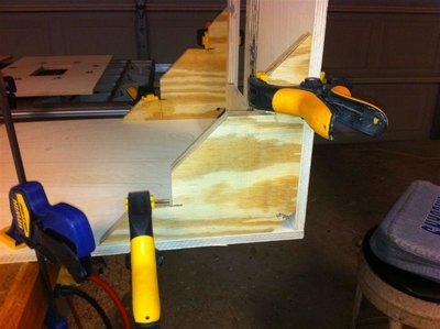

For keeping the panels square, build some of these.....

Okay, that makes sense. I already have some holes drilled in the layout from marking the centerline on the opposite side, so will use those to pull the panels together with screws, then shoot brads in between. Need to go make up some of those clampy triangle things...
thanks Bruce!

Clamps and triangle jigs work fine at the outside corners, but they won't give perfect joints across the cab the way the jigs shown in the plans do.

Panels 1 and 2 in, looking really square so far. The driver access hole made it easy to get some long clamps in there to cinch down panel 1 tight, then the screws, followed by a row of brads. I had some metal shelf brackets that work well when clamped to the side to keep the panel at a right angle when setting it in place and until panel 2 joins panel 1.

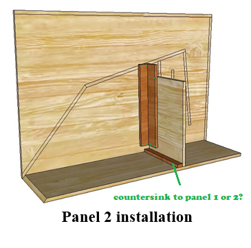

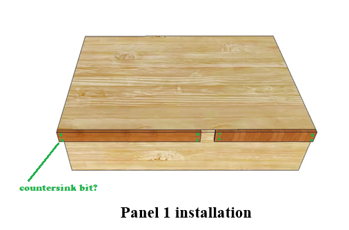

Ok, thank you , i understand that part now . however I do not understand some of the instruction in the plan for example:
Code: Select all
Put adhesive on panel 2 edges, place it and screw it to the jigs. Fasten panel 2, remove the jigs, fill the holes with adhesive.
What does it mean by fasten when you already screw it to the jigs. also how long do i need to wait before removing the jigs? There is also a thing i do not know and i has attach the question in the image.

Code: Select all
Use a framing square to draw the joints with panels 2 and 4 onto panel 1. Screw the 2 degree edge scrap to the joint of panel 2 with panel 1, screw a right angle jig to the joint of panel 2 and the side. Put adhesive on panel 2 edges, place it and screw it to the jigs. Fasten panel 2, remove the jigs, fill the holes with adhesive.
1. Use a framing square to draw the joints with panels 2 and 4 onto panel 1
i understand this as a joint that i need to drill a pilot\countersink hole through the middle of each joint , 1/16 inch or so diameter, about two inches from both ends of the joint.
2. Screw the 2 degree edge scrap to the joint of panel 2 with panel 1
what does this mean, using the joint from step 1?
3. screw a right angle jig to the joint of panel 2 and the side
the right angle jig should align beside the 2 degree angle panel 2 right.
4 .Put adhesive on panel 2 edges, place it and screw it to the jigs.
screw it to the jigs and what about the side joint mentioned earlier. should i screw it too or not. also how to screw panel 2 to the scrap 2 degree jig the angle is too steep?
