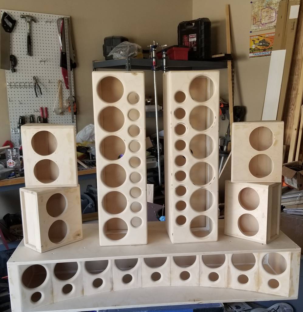

Well, life happens. It’s been awhile since I posted on this. I was able to get back in the garage and do some more work on them.
Without further ado, here are the pics!

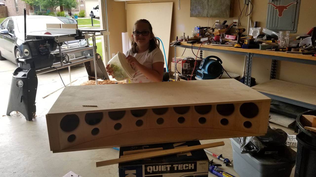

Now the next step is to paint. The wife just wants them done. I’m debating whether or not to prime them with the automotive spray primer I have on hand. I have Valspar paint/primer in one. I was wondering how to proceed. They will be hung in a dark room, nobody touching them, and RARELY moved if at all. Will just painting be good enough?
Semper Fi
TX
Posts: 7688
Re: Finally Starting the Theater Build
#33 Post by Tom Smit »
I would do up right, using primer, because you will want to show them off! :hyper:

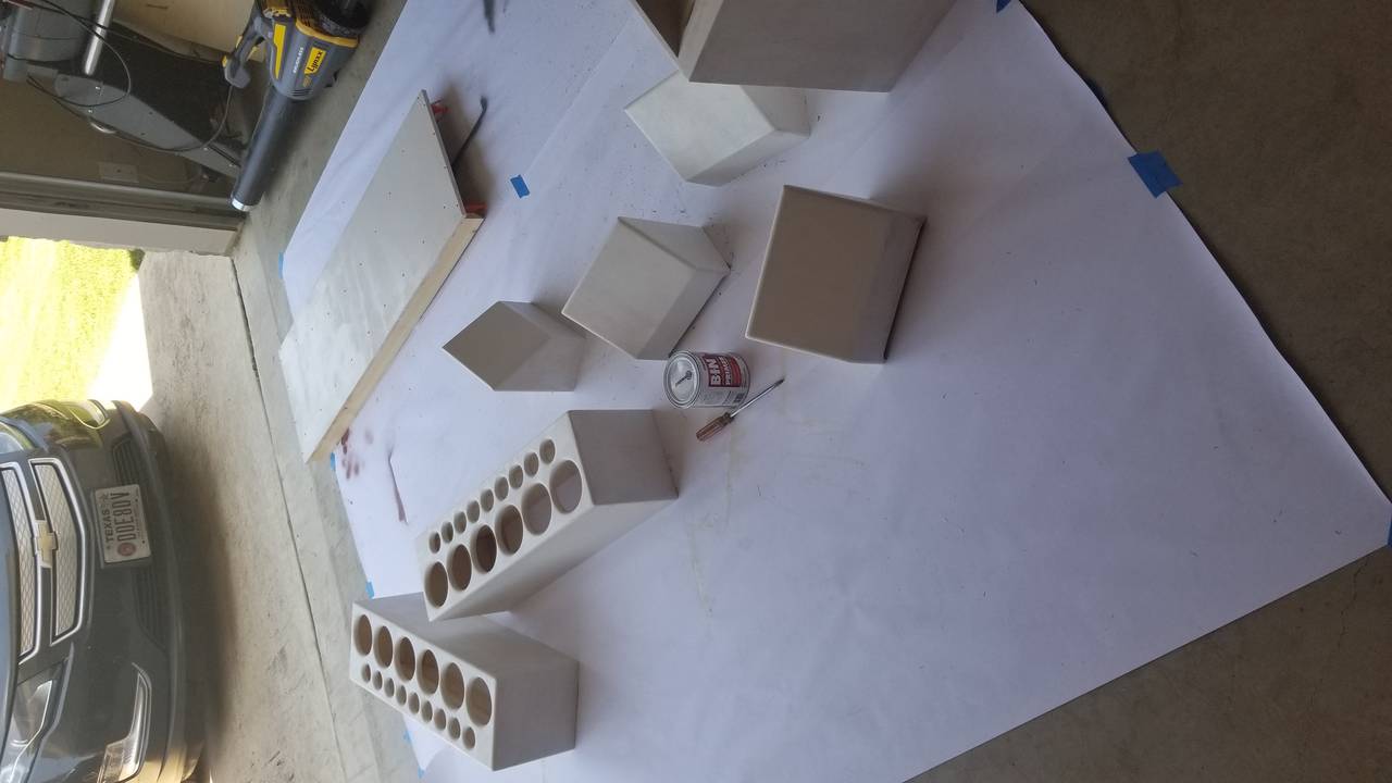

Thanks Tom, I was leaning that way, just bit the bullet and did it.
ALL my cans of primer had NO propellant in them, much to my dismay. Quick trip to Blue Box store set me right. Spray primer is $8 a can!! When did it get so expensive? Bought a quart of the BIN primer and went to town.
Glue Monkey wanted to help so I gave her a brush and cut her loose. We put it on a bit thick so sanding will be fun....
Pics.
