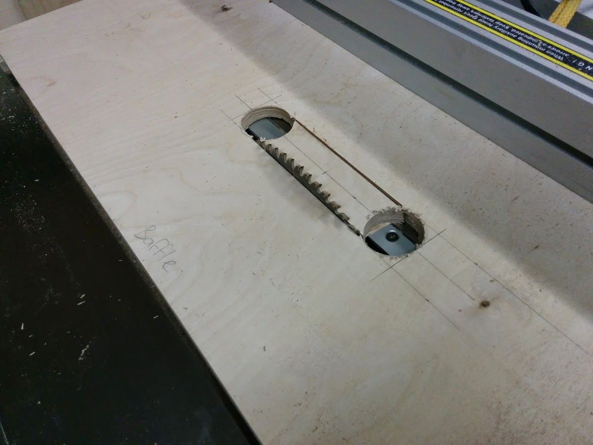

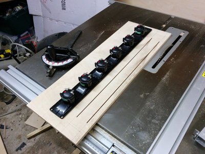

I started by cutting the rough whole for the array using the table saw:

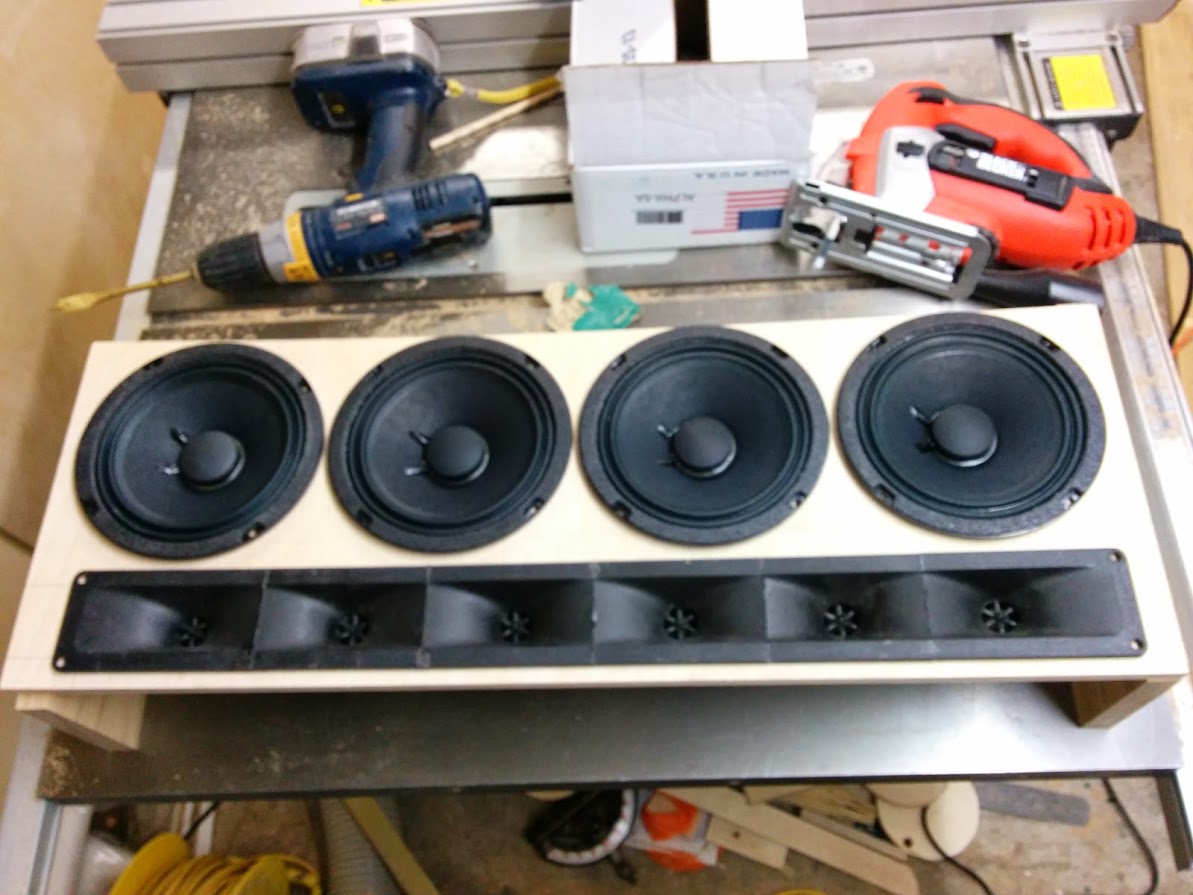

I glued and built the array last night:

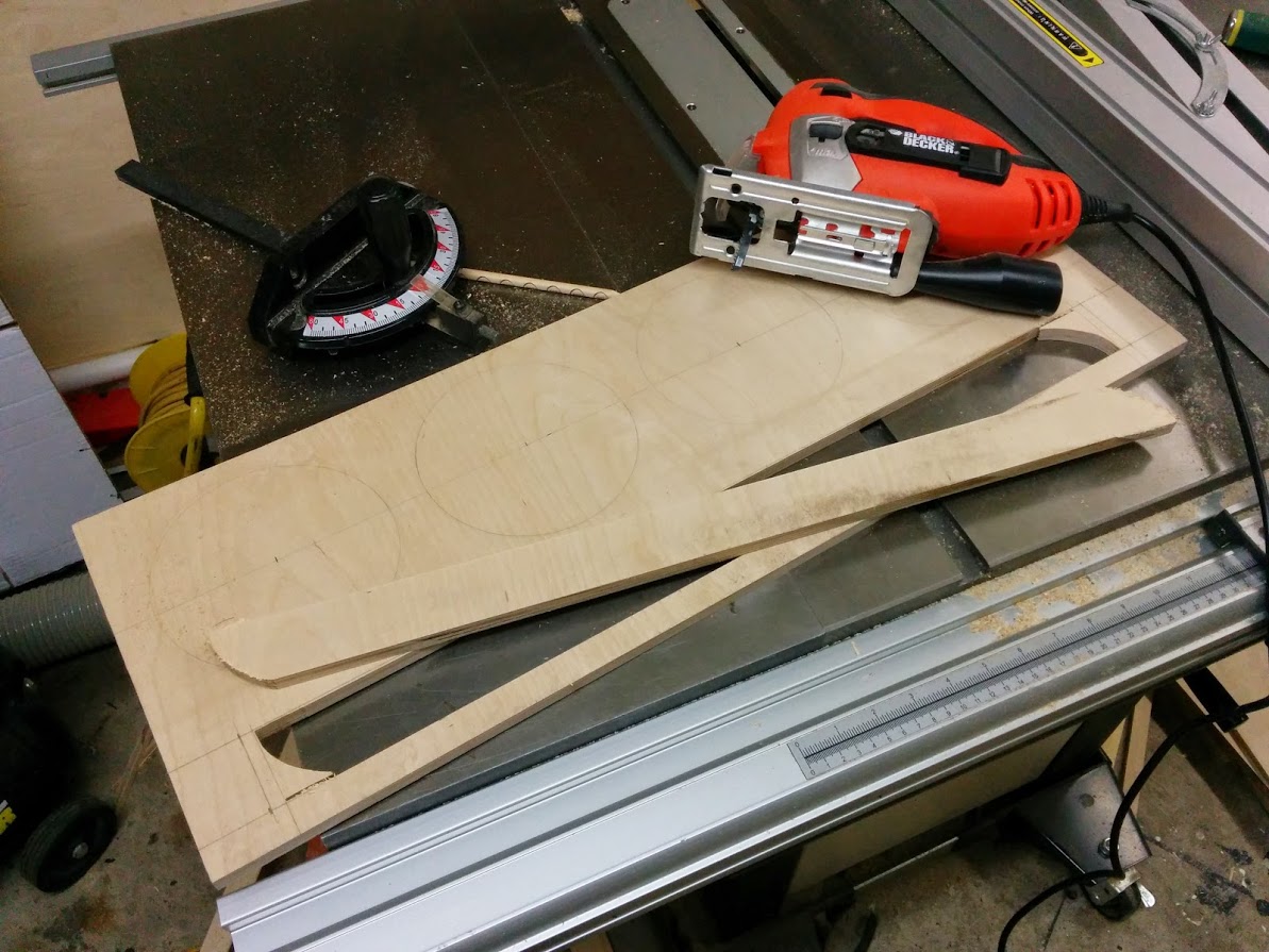

A quick jigsaw and the hole is made:

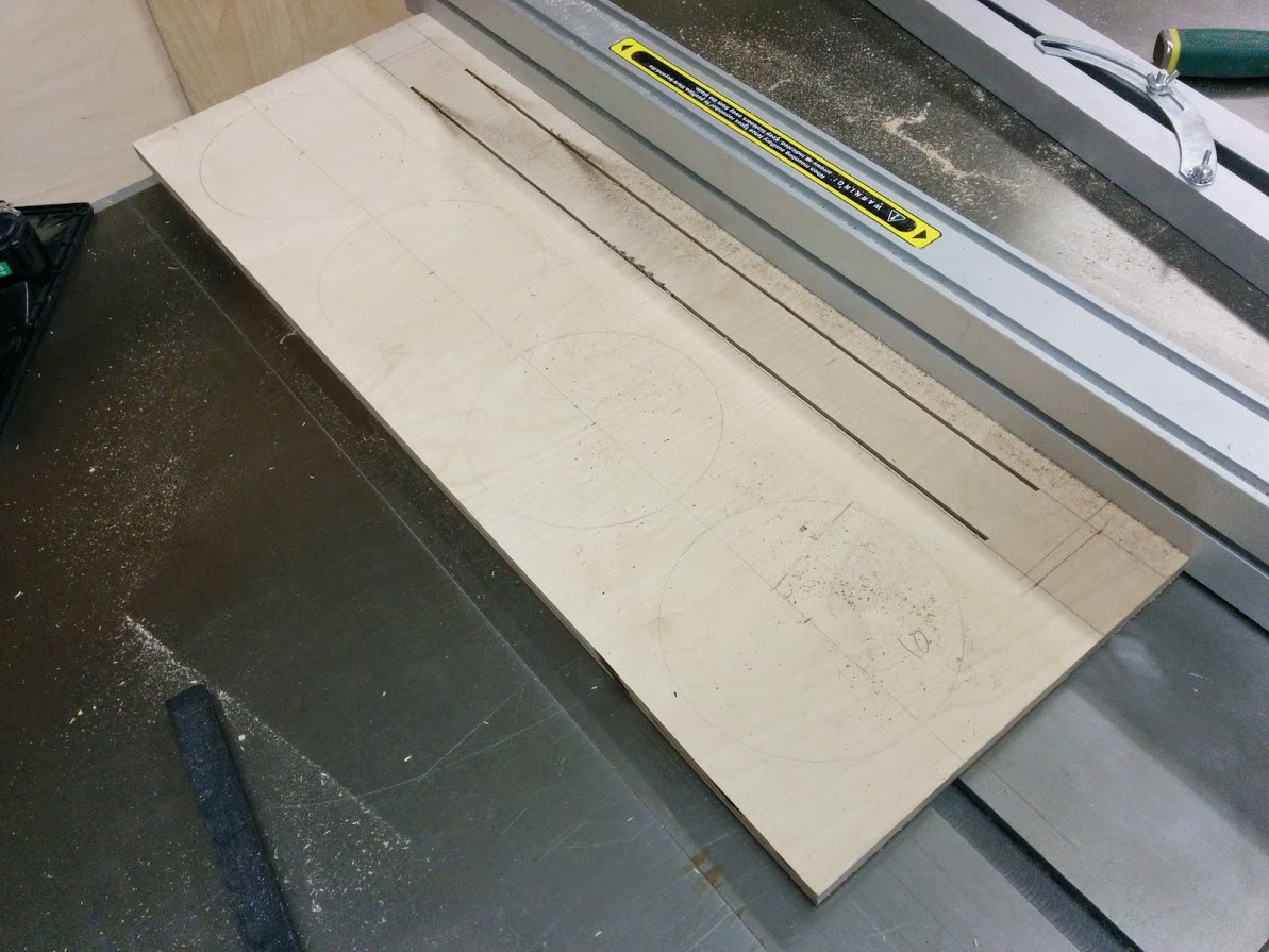

I jigsawed out the driver holes and tested the positions:

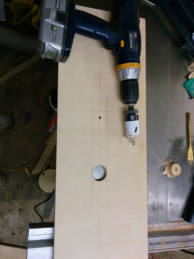

For the handles/ports, I first drilled a 6mm hole as a guide then using a 1 1/2" hole saw to complete:

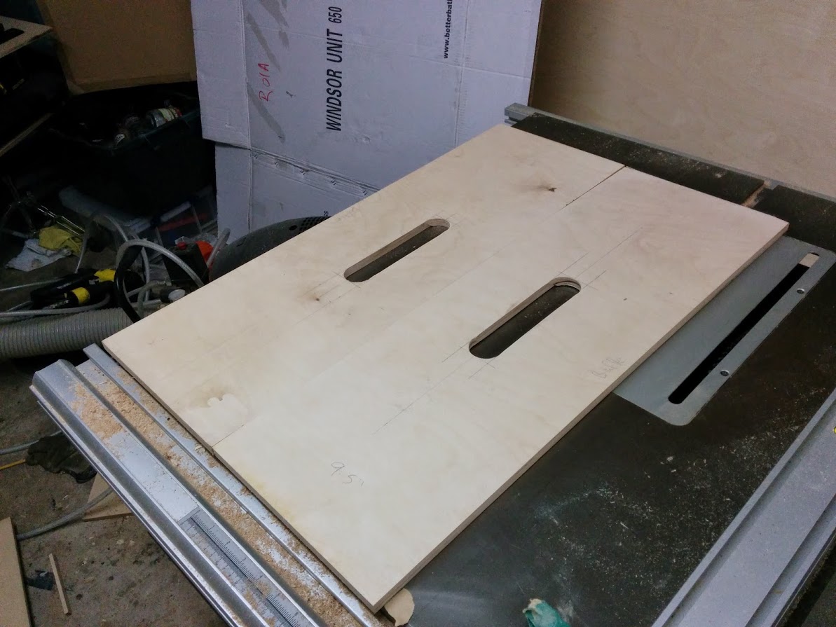

It was back to the table saw to finish the holes:

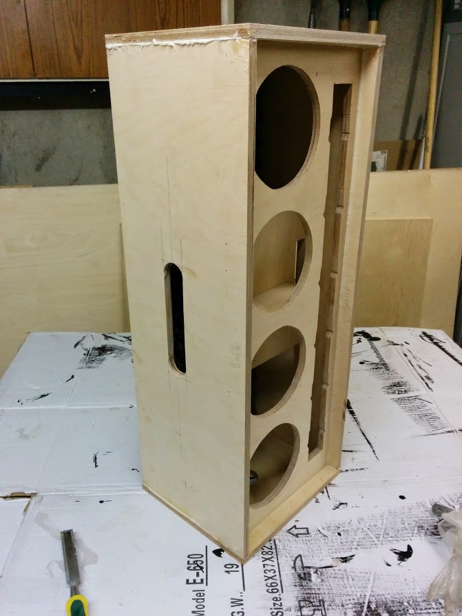

A quick sand and they are done:
Some glue everywhere and a few misguided nails, this is what I have:

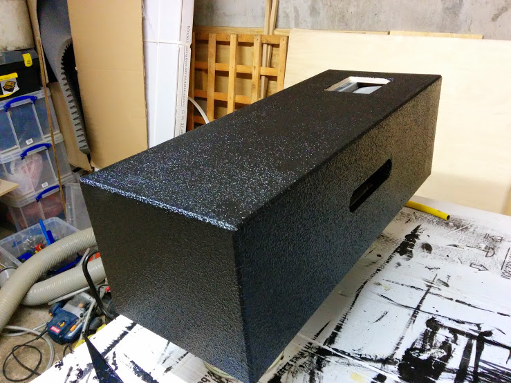

Fast forward to the textured paint phase. The areas that have had filler are showing up as a slightly darker colour. I'll have to keep an eye on that once the paint has dried.

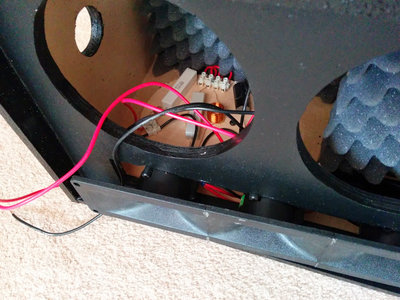

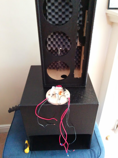

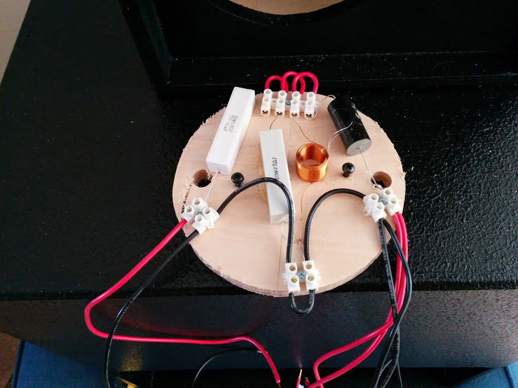

The final stages, I found some time at lunch to do some wiring. Here is the crossover glued and screwed to one of the holes for the drivers:
I'm not a fan of soldering in case i make a mistake:
I sat the crossover at the base of the cab and secured with screws:

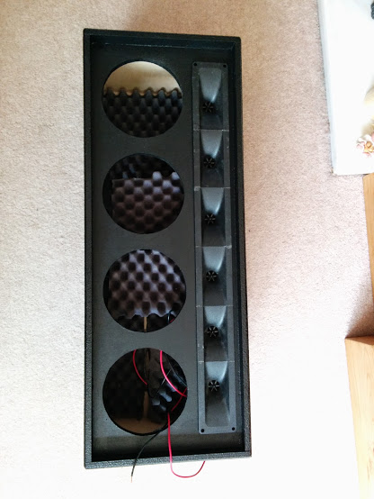

Unfortunately the piezo array didn't fit as it was pushing against the crossover:
A quick fiddle and everything was fine:

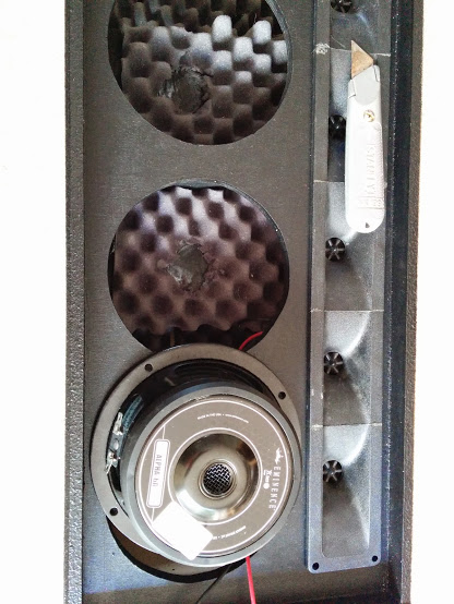

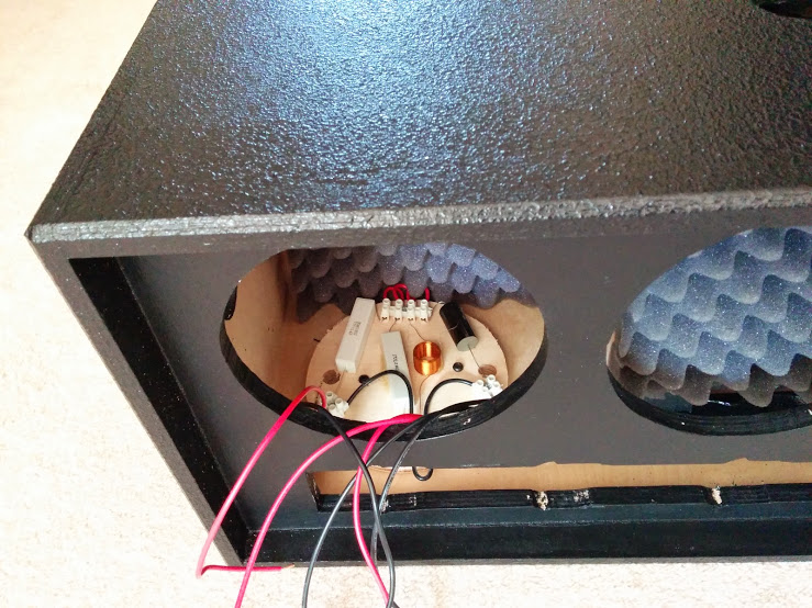

The Alpha 6's where pressing against the foam of the brace, so I cut some holes for the air hole at the back of the driver:
The wiring was down behind the driver and we are ready for screws this evening:

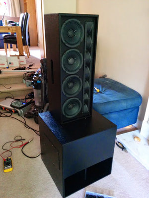

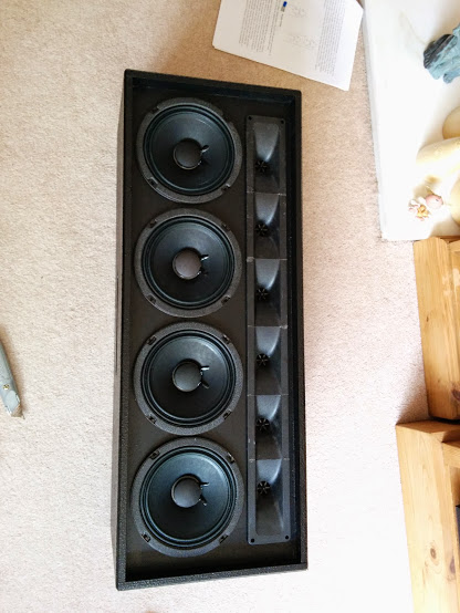

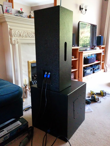

She's alive!
I need to do a bit of EQ'ing, I think it's a little 'honky' - we'll see once I get everything setup.
