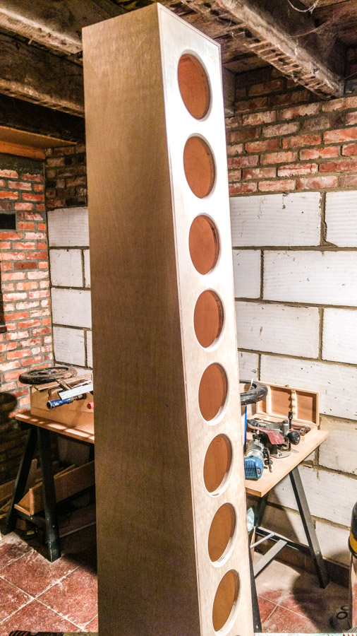

I also made a different choice about the design of the cabinet. I like to see the wood and use the multiplex layers as a style element. I also made it myself a bit more difficult by tilting the front panel by 4°.
Next my build process:
The corners of the cabinet are all cut at 45°, this way the layers of the multiplex will make nice corner. The frontpanel is recessed into the side panels.
First fit of panels
First fit of panels
Routing holes in the front
Corner view front panel
I test fitted the drivers. No glue yet, only hold by the blue tape :D
Test fitting drivers
View from back, test fitting drivers
