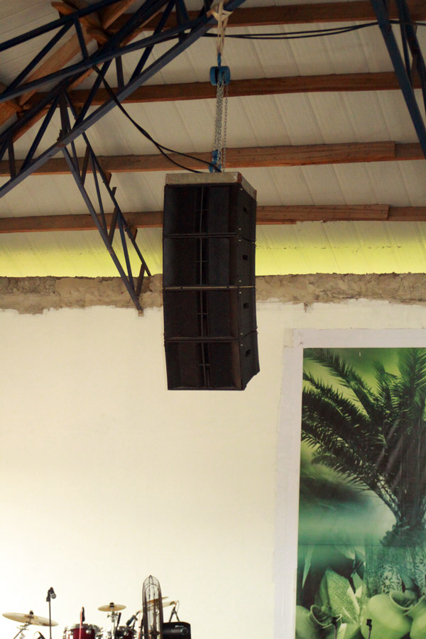

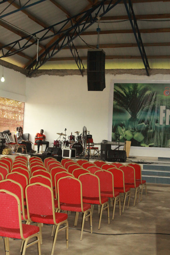

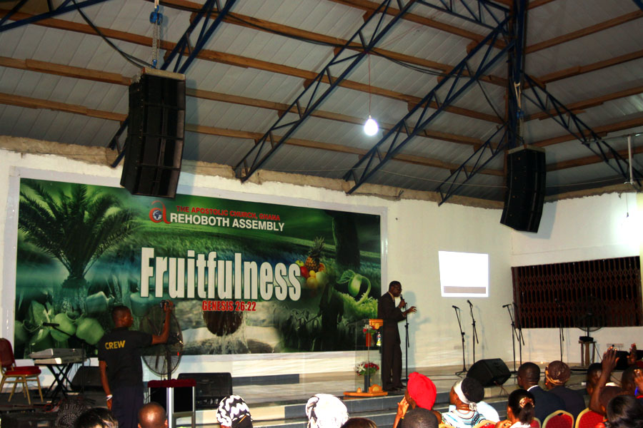

Here are some pictures of the flown Otop 12 Jarrays

Could you get a picture of your rig that is lifting the speakers? I see what looks like a square frame, but I am curious as to how it allows for angling up where the hoist hooks on.

Those pics are inspiring. But, the OTops, are heavy enough to kill someone. Explain your rigging in detail because, in my church, this is a question that must be addressed.cave wrote:those cabs are not so heavy.

The cabs looks heavy but they are about a quarter or even less than what the same rig carries. I will post drawings soon. thanks
