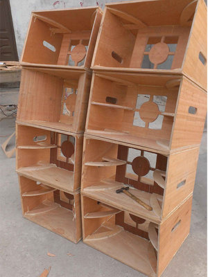

Hi folks,
My brother and I built two dr250s two years ago wihch served us so well. We decided to make a complete four per side dr250 and 8 titan 48s. We started the builds and are almost through however, we developed a huge interest in the otop12_Jarray and so have started to build 8 boxes. we intend to rig them with a method we found on youtube which we used on a different line array project.
http://www.youtube.com/watch?v=r6gqIQD8ZiY
Forgive me for not posting pic. i will send pictures soon. i must say the 8 Otop_Jarray builds are like a breeze compared to the 8 DR250's

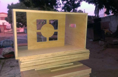

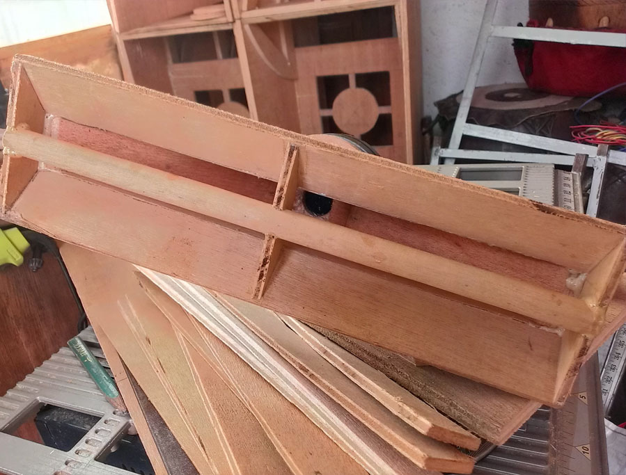

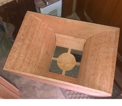

We continue our build today hopping to work for about eight hours. We intend putting together all the compression driver horns today and fitting them as well. Below is the first one we built

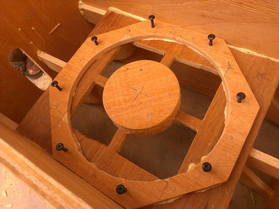

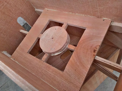

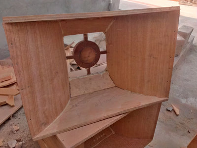

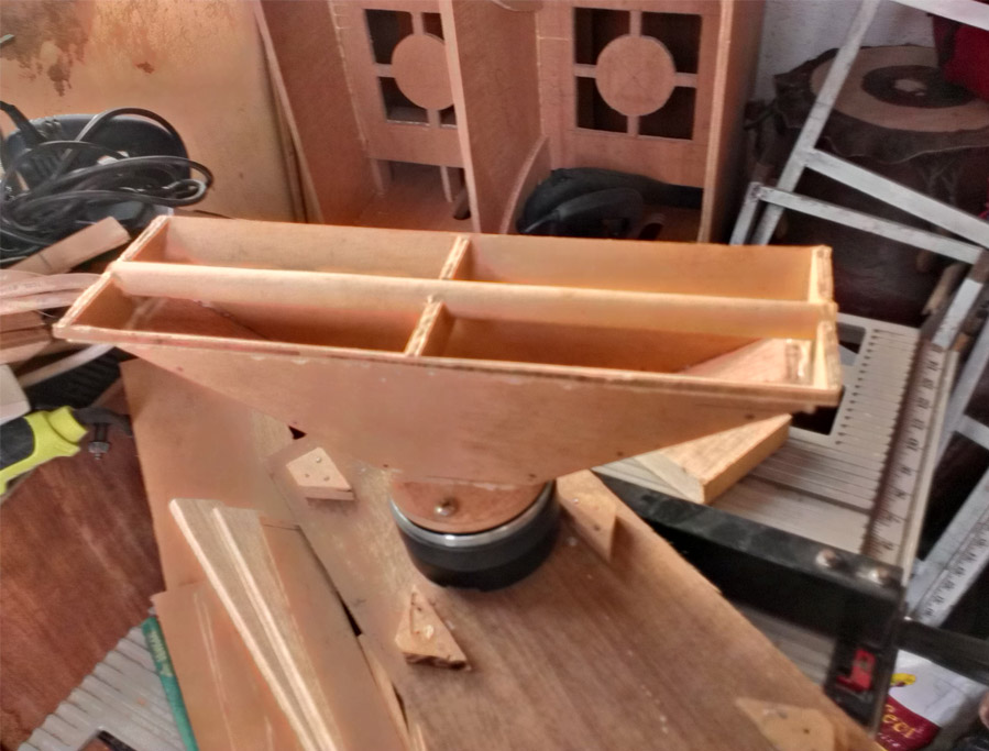

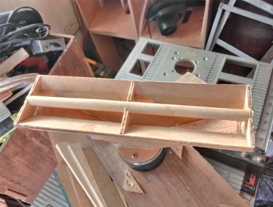

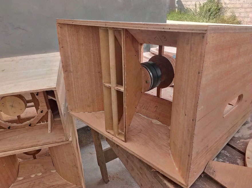

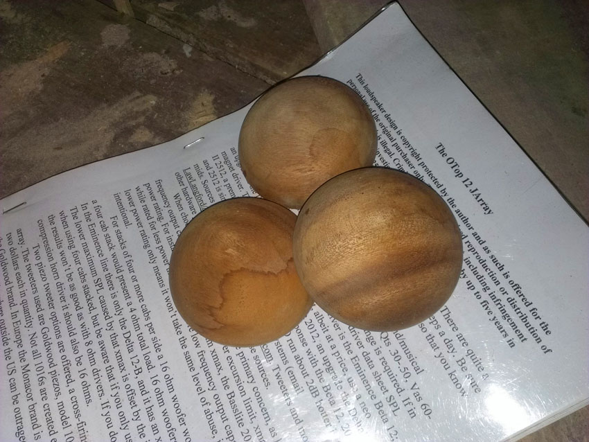

We progressing steadily on the build I have a lot of pix to post to day. We had to use wood for the Phase plug. We also had to lathe the 3 inch dome out of wood because we couldnt get styrofoam balls. We have all braces and T-Nut speaker baffle installed. All eight HF horns are ready for installation. Pix follows.

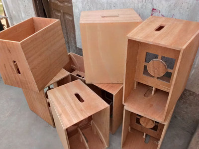

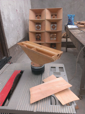

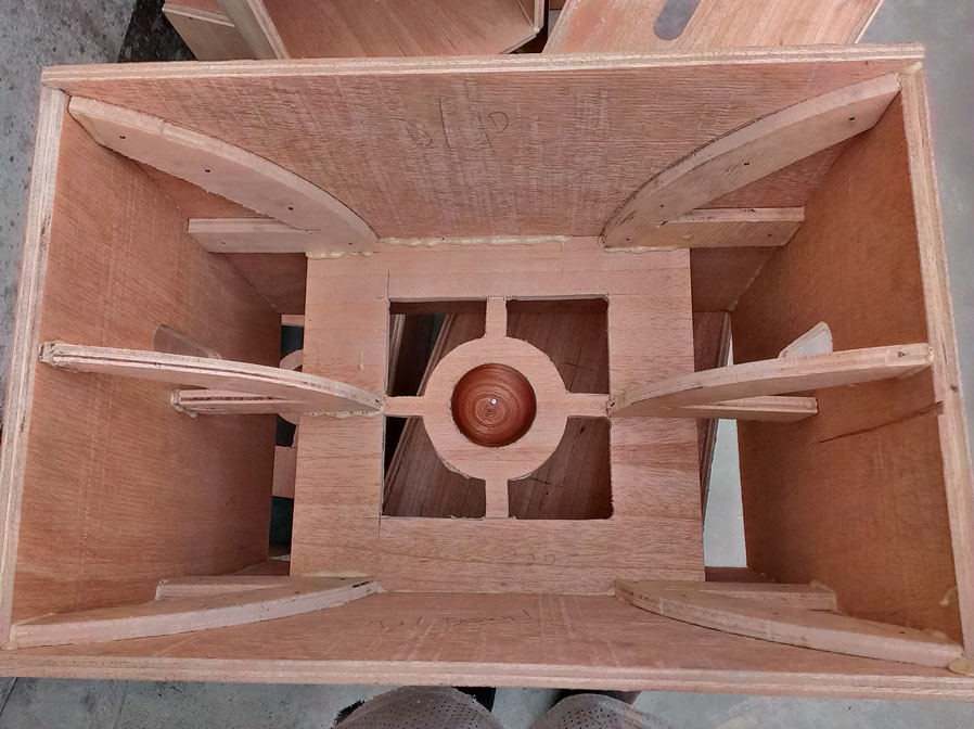

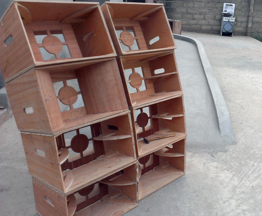

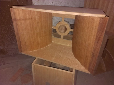

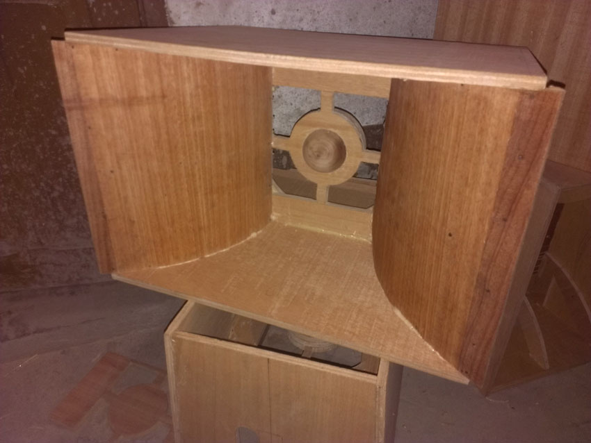

More build pictures for you.

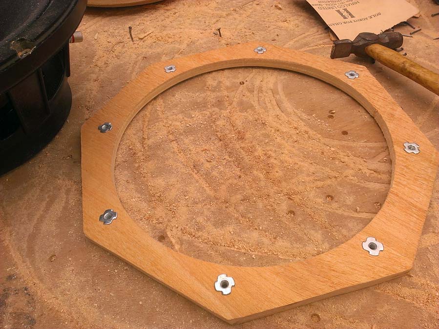

I hate to be the bearer of bad news, but your T-nuts are installed in the wrong place. You should've glued the spacer to the baffle, then drilled through both the spacer and baffle at the same time. Then, install the T-nuts on the horn side of the baffle, pulling them in from the spacer side. If they are not epoxied or glued to the spacer, you can save them T-nuts.

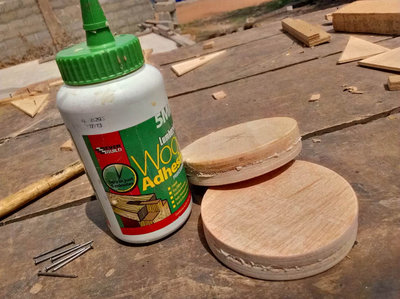

is that the glue you're using for the entire build??
Re: OTOP 12 JARRAY PROJECT.
I showed the under side of the spacer which will be glued to the baffle. the picture below shows the spacer installed. Hope that's what you were talking about.DJPhatman wrote:I hate to be the bearer of bad news, but your T-nuts are installed in the wrong place. You should've glued the spacer to the baffle, then drilled through both the spacer and baffle at the same time. Then, install the T-nuts on the horn side of the baffle, pulling them in from the spacer side. If they are not epoxied or glued to the spacer, you can save them T-nuts.
Yes thats the glue very effective for the job.Grant Bunter wrote:Looking good so far!

We don't know where you are, but could you not get the recommended adhesive?cave wrote:Yes thats the glue very effective for the job.Grant Bunter wrote:Looking good so far!
ie PL Premium.
It's amazing stuff.
Be that as it may, you need to be ultra careful now about making sure that not only are all the joints structurally sound, but also entirely leak proof!
