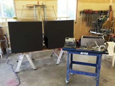

Quick update,
Delayed by rain and believe it or not SNOW!!!. Disadvantage of a northern climate. Normal temps for this time are about 18 Centigrade but it dipped pretty low a few days ago. I have to push the aircraft out to be able to work on the speakers so had a four day period that I couldn't do that, days that I had free of course.
I now have 3 units ready for paint and the 4th unit was closed up today. Two more days of construction and I will be painting. If I don't paint them before moving them into the house it would never happen.
Drive units are being run in and should be finished before the cabinets are ready to receive them. People have been lined up to help me move them into the theater, starting to see the finish line.

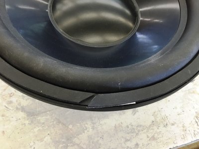

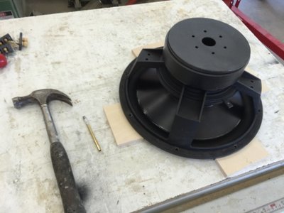

I've attached some photos below. I scarfed jointed the seal on the face of the driver and also on the cabinet and I also used a piece of thin wall brass tubing to punch holes in the seal on the drivers so the screws would not tear the rubber. There were no leaks at all on either the driver seal or cabinet seal, a quick test at 50 Hz had my shop resonating!!!! I used a number 60 drill bit to put a pressure equalization hole in the cabinet near the connectors.

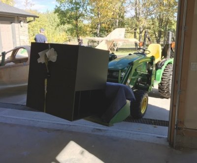

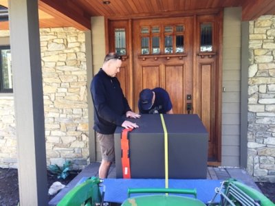

Some shots below of moving day, I used my tractor to carry them to the house, I let my son and neighbor do the hauling down the basement stairs.

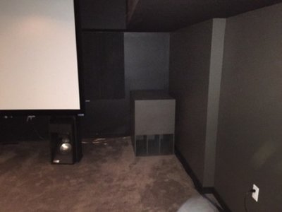

You can see from one of the shots that the THT's are placed in the room corners with the throat firing into the room. I had spent a lot of time with the 8 twelve inch sealed box subs previously and had found that for my room that positioning gave me the overall smoothest response. I don't need the gain that would come from firing the units into the corner itself. (Four of these in the room could take the walls out if I wanted to).
For me it has all been about getting the least variation across all the seating positions and getting the lowest distortion performance and not insane bass to rattle my teeth. These units are just loafing in this application, barely breathing.
I used my Lexicon MC12HDEQ to tune them to the room and the results are fantastic. I can't show any "numbers" as the Lexicon doesn't display what correction it has applied. The THT's are being used on the LFE channel. For music my mains go down to 20 HZ and have sufficient capability to handle any music, despite being dipoles and the inherent excursion for the bass drivers. Movie sound tracks are a different story however and so when watching movies the mains are cut at 40 or 50Hz and anything below that frequency is transferred to the LFE channel.
The performance of the THT's is fantastic, it has exceeded my expectations, the sealed subs were not exactly shabby but the THT's go deeper and audibly have much lower distortion than the sealed subs. They also integrate better with the mains. I'm very happy with the results.
The acid test, and this has been quoted so many times by so many men, my wife, unsolicited said, "I can ear the bass better, it's cleaner". She is a Jazz Saxophonist and has played in big bands so her opinion carries some weight for me.
