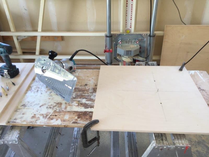

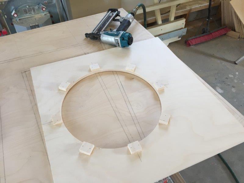

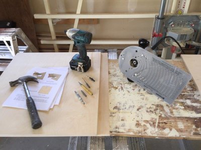

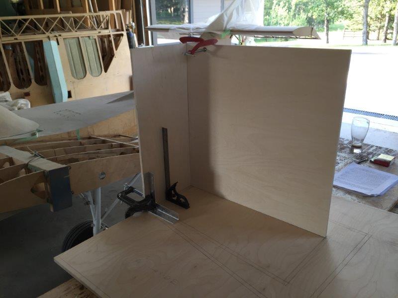

OK I'll try and post some photos here, spent several hours in the shop today. Primarily finished up panel 4 for each unit, I have an extensive workshop, one advantage of 70 years is the time to accumulate the toys!!! Shots are, in reverse order.
My Jasper Jig ready to make those baffle cut outs,
Some tools used, I had a hinge screw centering bit that perfectly centered pilot holes for the intended socket head wood screws now on their way from Parts Express.
A finished panel 4 with the backer blocks glued and pinned to the back of the panel
A dry fit of panels 1 and 2.
I have some excellent right angle "jigs" from Leigh Valley that I use for cabinet construction. Note the try square, it's a genuine Starret and worth every penny. I have tried the cheap Chinese knock-offs of a lot of tools from home depot, useless. One thing I have learnt is that good tools are not cheap and cheap copies are a false economy.
Yes that is an aircraft under construction in the background.
