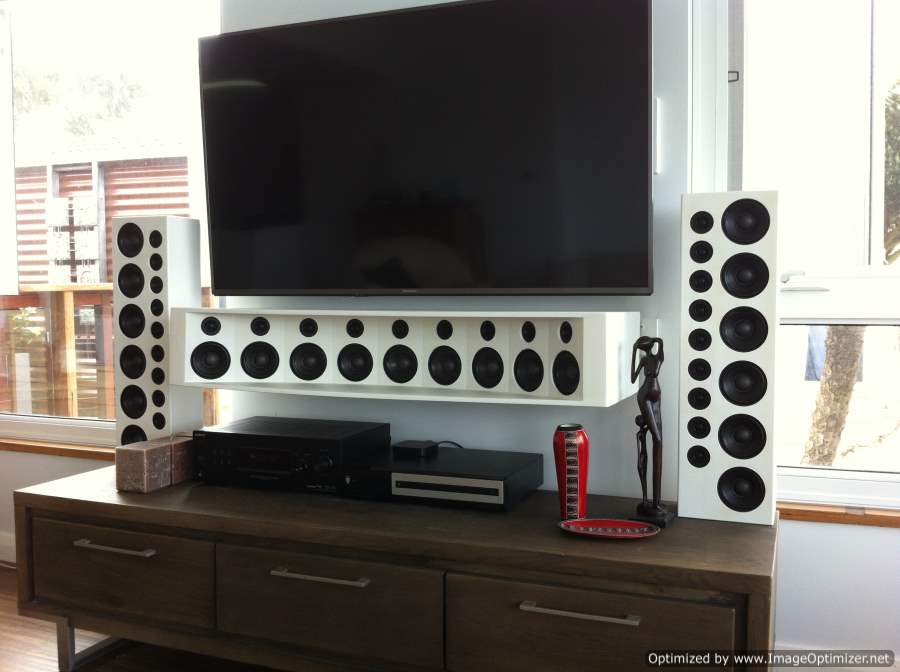

and for anybody reading this, here are the matching 6 driver version of the SLA's finished and in pride of place surrounding my new TV :-)

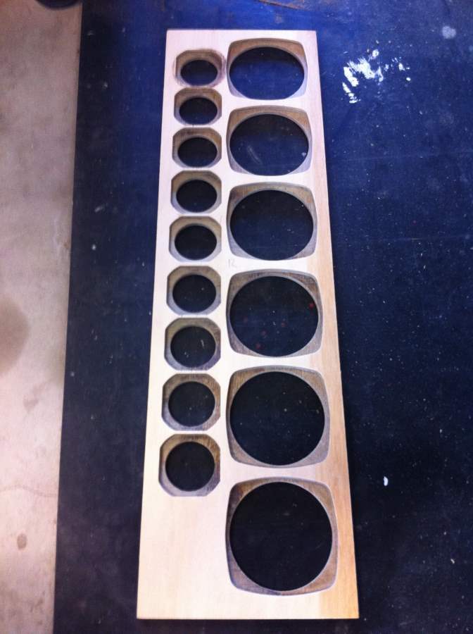

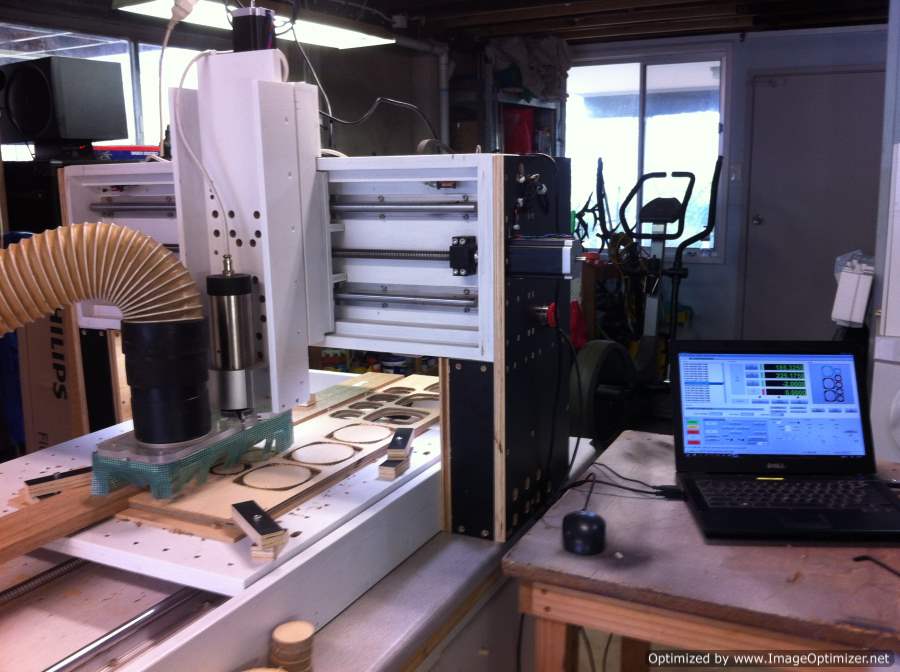

Cutting the baffles. Note: the baffle is longer than my CNC table so this is done is two passes (sliding the baffle up in between)
Completed baffle
Completed baffle

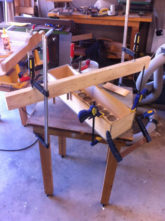

SLA glue up all in one go.
If 18 drivers is good, 48 is better :-)

I have a list of friends that want me to call them next time I fire it up so they can come over and watch. So you're not the only one that likes it.
And I must admit, I find myself standing there watching it work while I could be doing something else.
