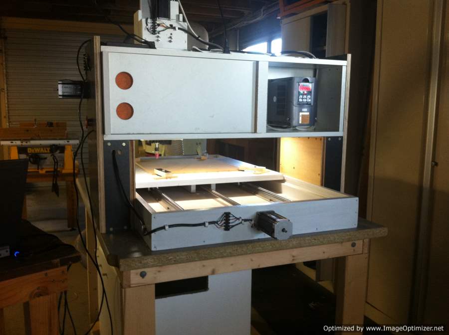

#2 Post by NeilD321 »

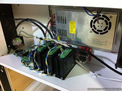

Firstly, here is my home made CNC.
I absolutely LOVE this thing and I'm happy to chat about it if anyone wants to.

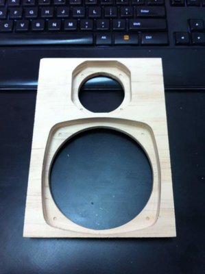

What on earth do I want with a CNC router?
Well, you can teach it to do this...

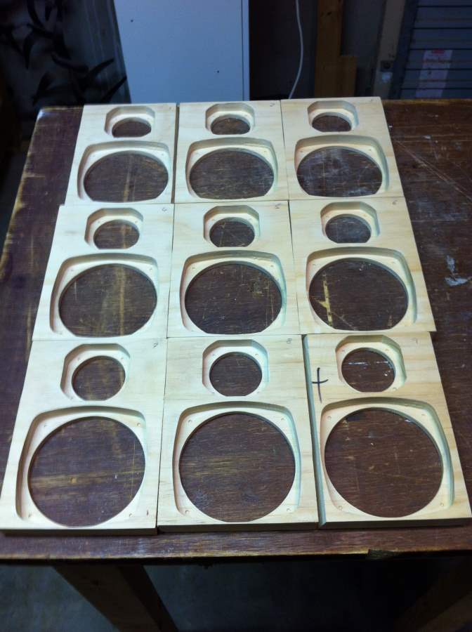

#4 Post by NeilD321 »

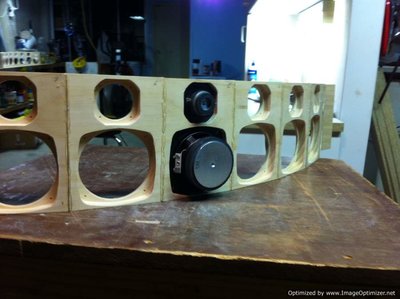

and then do that 9 times (while I watch the TV)
Stupidity should be painful
NeilD321
Posts: 112
Location: Kiama, Australia
Re: That's not a speaker. That's a piece of art!!
#5 Post by NeilD321 »

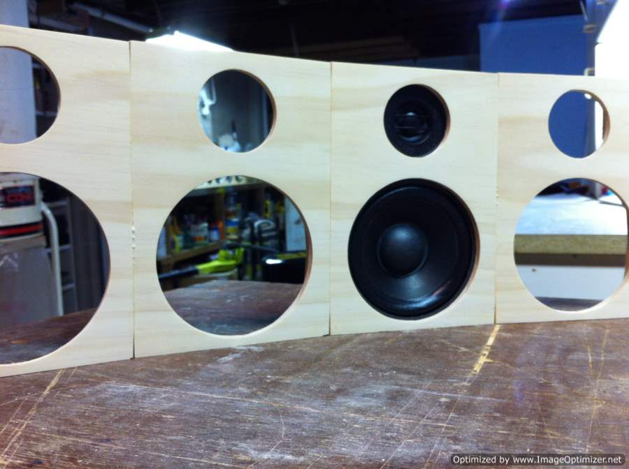

This means the drivers will fit in from behind. I was going to use tiny screws to hold them in but the fit is SO good I simply used hot glue.

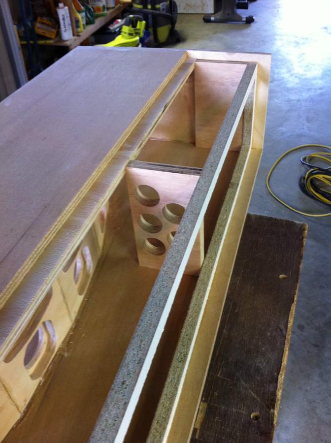

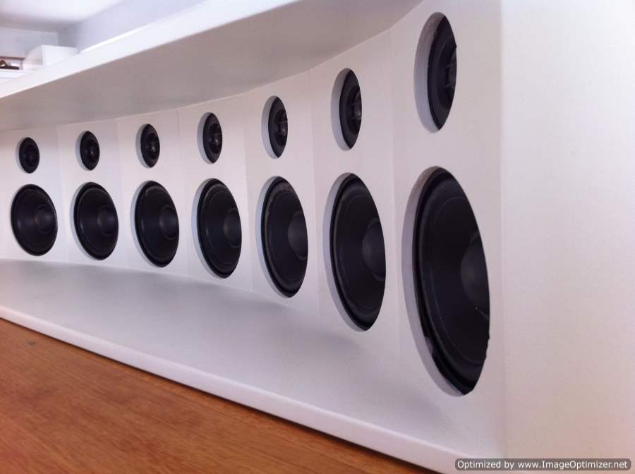

Next was the change to the carcass to eliminate the bottom line and strengthen the back.
Hopefully this picture tells a thousand words.

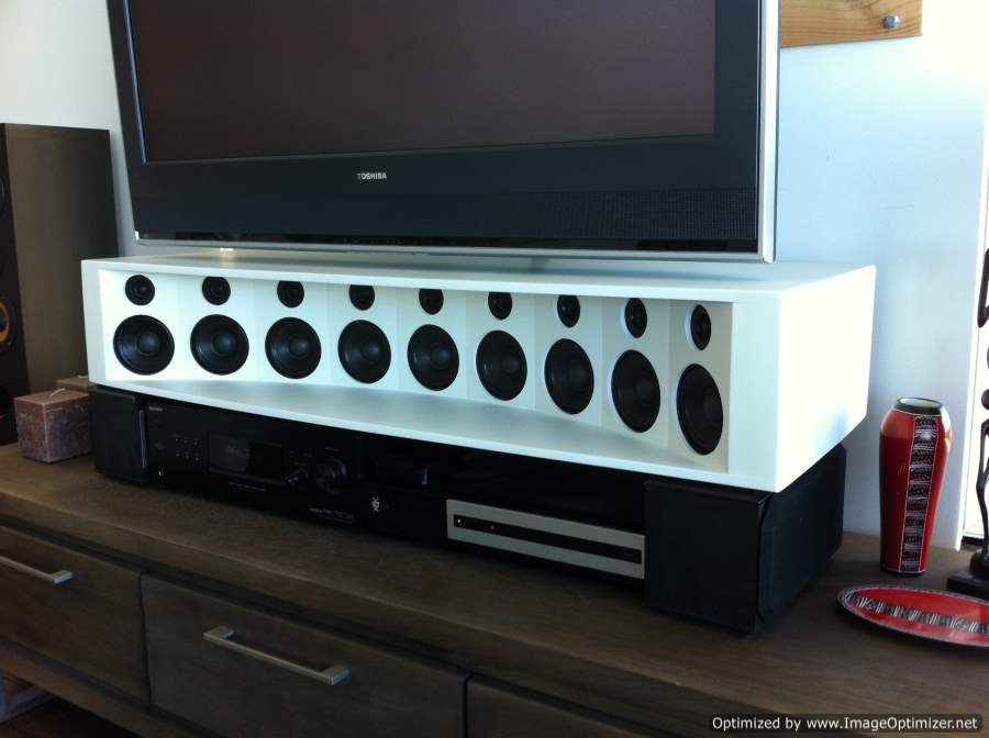

#8 Post by NeilD321 »

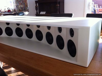

and cutting a long story short, here's the final product.

Building it was a piece of cake. Getting it to run was another thing altogether...
I chose to build this model from a guy in Germany http://www.holzmechanik.de/solidis_eng.html
Mainly because I have plenty of experience cutting timber but none in metal.
Mine has a bed size of 600mm*600mm, which is twice as big as the one in the link and because the table moves (not the gantry) it takes up a bigger footprint.
The upside of having the table move is that the X axis is VERY stable. Downside is that the table is longer.

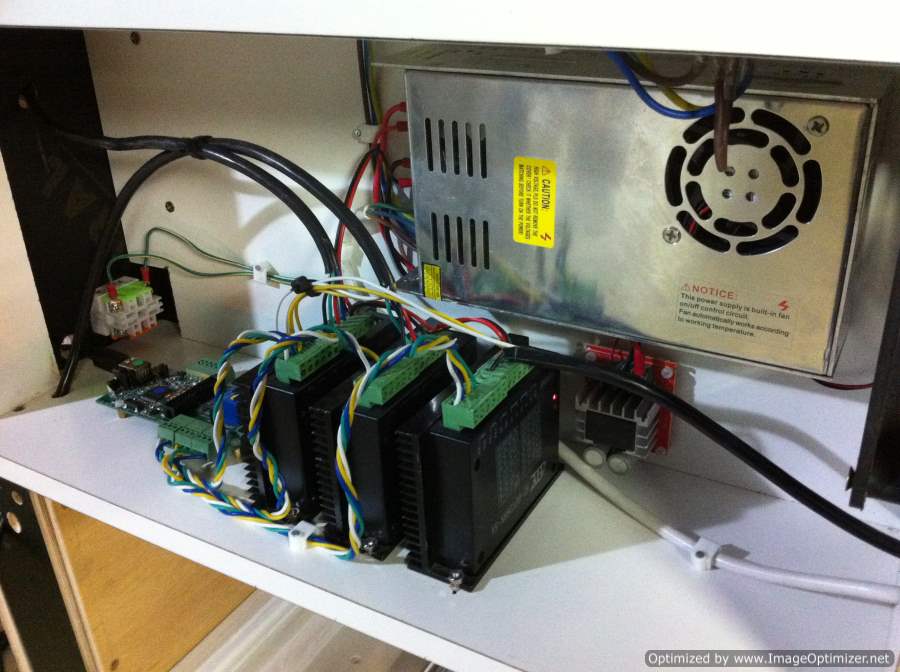

I do have a back ground in computers but that's not the hard part. The hard part was getting the correct electronics to all work together.
So my hardware chain is:
  • My Laptop, running Mach4 and connected via USB to,
  • A motion controller from PMDX. I have the PMDX-422. ->
  • 3 stepper controllers ->
  • 3 motors =>
  • 3 ball screws and linear rails.
  • A 1.5kw spindle with matching inverter (speed controller)

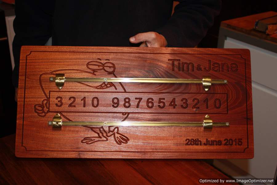

Whipped this up as a wedding gift one Sat morning :-)
