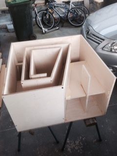

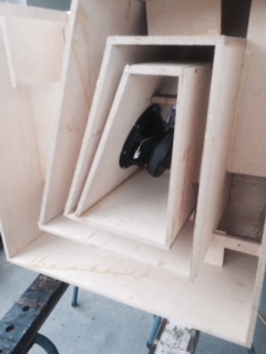

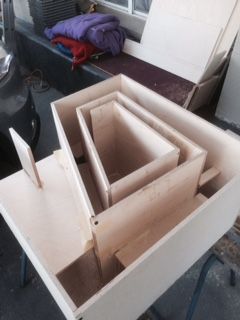

A few hours on the tools today...and most of the internal finished except for the baffle (waiting for driver from Parts Express).
Heaps of poly glue used.
Some braces off by a few mm, but not seen. As I pre cut them first, if I did it again, I'd build them as I went, as the upright panels vary by a few mm when glued in place.

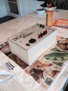

Also knocked up a small ply box for a new BASH 300-watt plate amp.
An enjoyable build.
An enjoyable build.

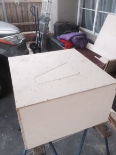

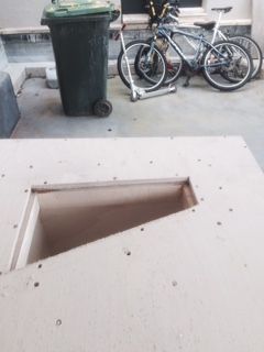

Access panel jigsawed out, and inner battens added. Getting close...just need that pesky driver to arrive.
This side of the unit will not be seen...as it will either be facing the floor or wall.

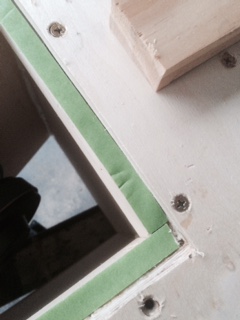

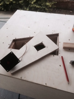

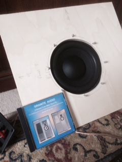

Driver finally arrived from PE. The Tang Band looks very well made...heavy. I used heavy gauge wood screws as the euro ply allowed great bite.
I added it to the baffle and ran some low freq test tones...all good there.
Added foam tape to seal chamber.
Terminals added.
Poly glue added and side nailed and weighed down....tomorrow I'll listen...then sand/paint.
Happy.
Terminals added.
Happy.

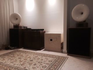

I'm doing leak tests now....I spotted a very fine leak at the chamber panel. I've added a thin beading of clear silicone around the panel edges....easy to slice through with a razer when opening the panel.Tom Smit wrote:Did you do the leak test with the hose?
Just ran up the unit tonight....very very impressed.
Test signal CD showed very flat down to 28Hz...then virtually nothing at 21Hz. No rattles at all in the cab...great sturdy design...love it.
Music test track Dark Side of the Moon, track 1 with the heart built.....massive increasing bass thump...had the whole house buzzing...amazing.
I like the detail of the bass.....eg bass guitar very defined.
Have some EQ added via MiniDSP...but will play around with gain etc in the next few days.
In the pic, the cab is firing to a 60cm deep 'nib' wall.
