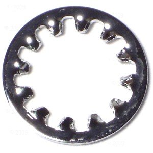

Are these OK?

Re: Lock Washers
Make sure they're high collar lock washers, when using socket cap bolts.

Re: Lock Washers
Not so much. These are better:
Re: Lock Washers
Bill, or anyone else - would you recommend using 'starlock' washers
http://www.ebay.co.uk/itm/2mm-3mm-4mm-5 ... 4d14b8a0a1
over regular toothed lock washers
http://www.ebay.co.uk/itm/m3-4-5-6-8mm- ... 3a7cdf7d84
or are they likely to perform much the same when it comes to ensuring bolts securing the driver in place (in a T60) do not shake loose?

Re: Lock Washers
The 'Starlock' washers have a completely different purpose. They're for slipping onto an axle to prevent movement along the axle while allowing rotation. Fuggedabootit!monekh wrote:Bill, or anyone else - would you recommend using 'starlock' washers

Re: Lock Washers
Thanks for putting that one to bed Rune!
