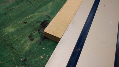

Disclaimer: I built my own woodworking shop set up with workflow exactly how I want it. Don't always keep it spotless but it's one spot on my property that I love being in. The main tool is my table saw that can make 50" cuts with tables around it to easily handle 5x5 and 4x8 sheets. Most of the cuts are made on the table saw so I don't use the track saw continuously. However, since I'm in the shop almost every day the track saw has seen a lot of use through the past year. IF I didn't have the space for a table saw and the track saw would be my "go to" every day I would probably get something like the Festool. That said, the Sheppach is a nice saw. It's definitely honest in it's pricing and has a lot of bang for the buck. I would choose it over a regular circular saw in a heartbeat and if woodworking wasn't an every day thing for me it would be the one to get for sure.

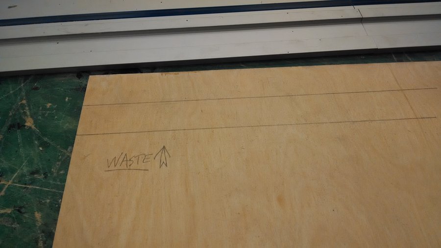

Ok. The wood I'll cut is scrap cheap Chinese birch with the thin veneer that splinters like crazy. (From a job requiring 3/4" ply without regard to using Baltic.)

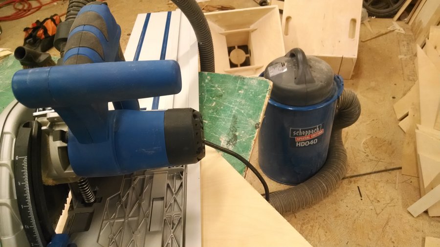

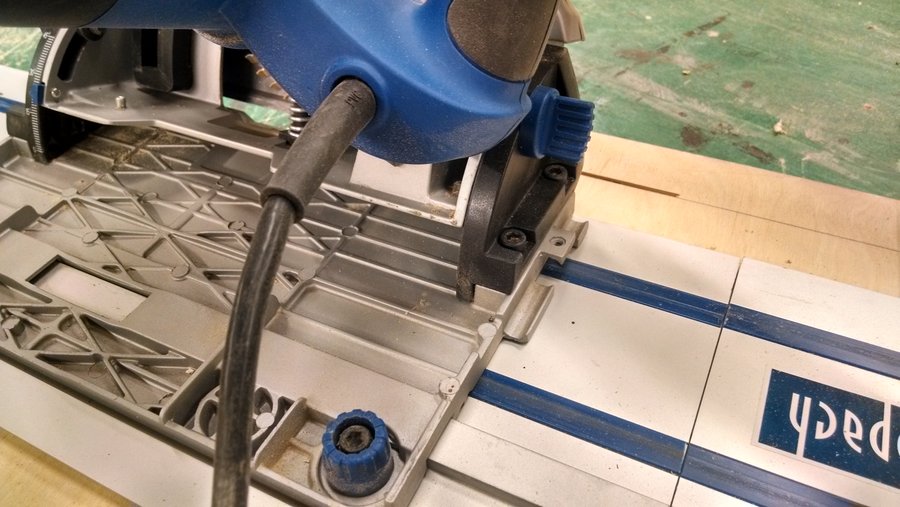

First picture is setup showing the handy dandy sheppach dust collector:

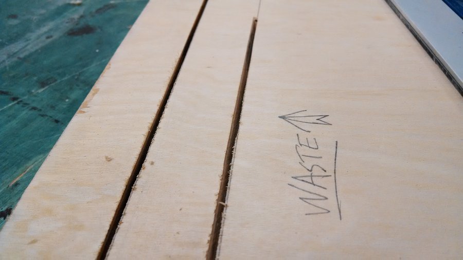

Lines I'll cut with waste side to the top:

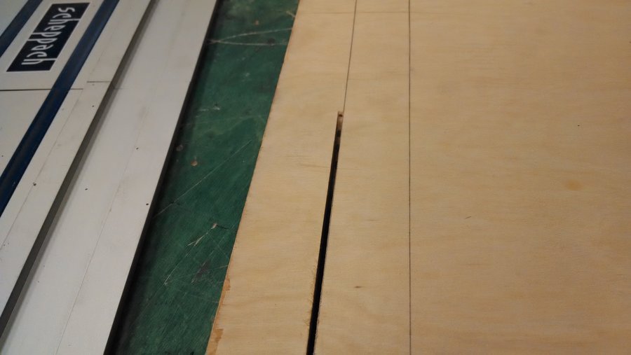

Track on the mark:

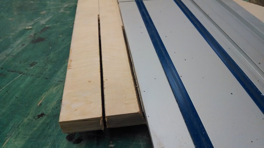

Result of 90 degree cut:
Here's the 22 degree cut:

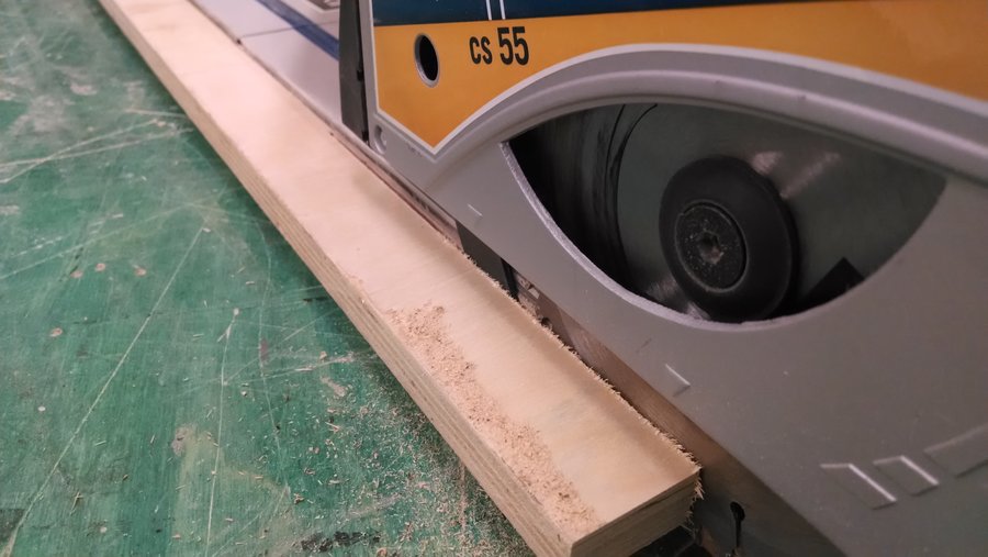

Here's the 22 degree cut with the track removed. First time I've tried an angle cut with the track saw and as you can see it slipped a little bit. It would be worthwhile to clamp for angle cuts:
Shot showing the riving knife (which works well) and the model number. Also shows how well the dust collecting works. Just a little bit beside the blade:

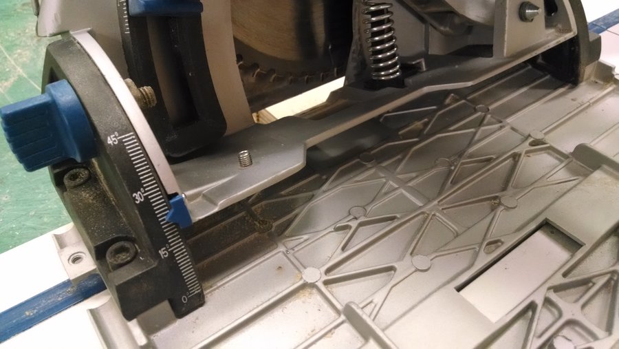

And two shots of the front angle stop and rear angle stop:
Didn't do 45 degrees but the way it pivots it looks like it would be about as accurate as any other angle.
I didn't take the time to really set up the cuts accurately. It's quick and easy to get 1/16" accuracy but tighter than that is possible if you take the time to set it up.
The first time you use the saw you first cut the rubber splinter guard to set up the track. The guard is cut by the saw blade so there are little nicks where the blade doesn't cut absolutely smoothly. I guess if you bought a really nice blade it would cut smoother but it's not really a problem IMO.
As you can see the wood splintered a little bit but well within the bounds that is required for cabs covered in duratex. And this is with a used blade. BB of course doesn't splinter as much.
Also, I've never had a problem with track wobble. Mine is perfectly straight.
