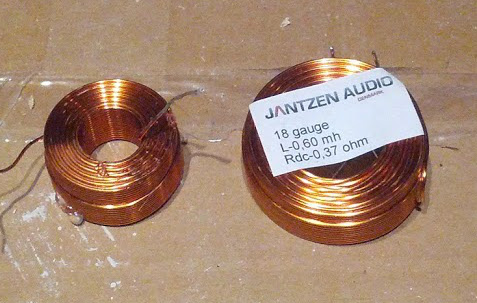

Replacement to-spec inductor arrived from PE. I snipped off the old one and soldered it on.
