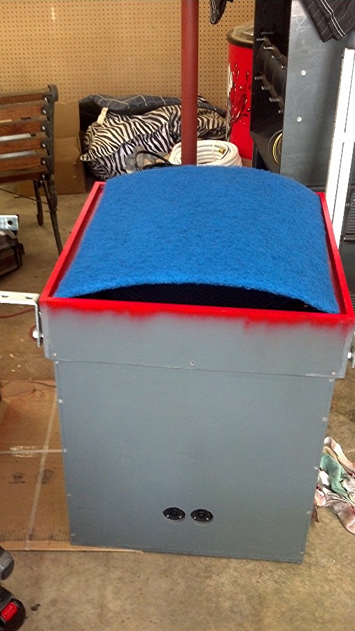

Second layer of weather protection . . 1/2" polyester filter media . . .
. .from the front . .

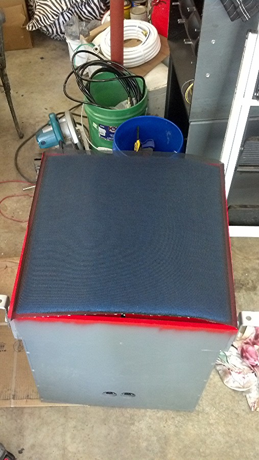

Third layer . . Pet screen . .

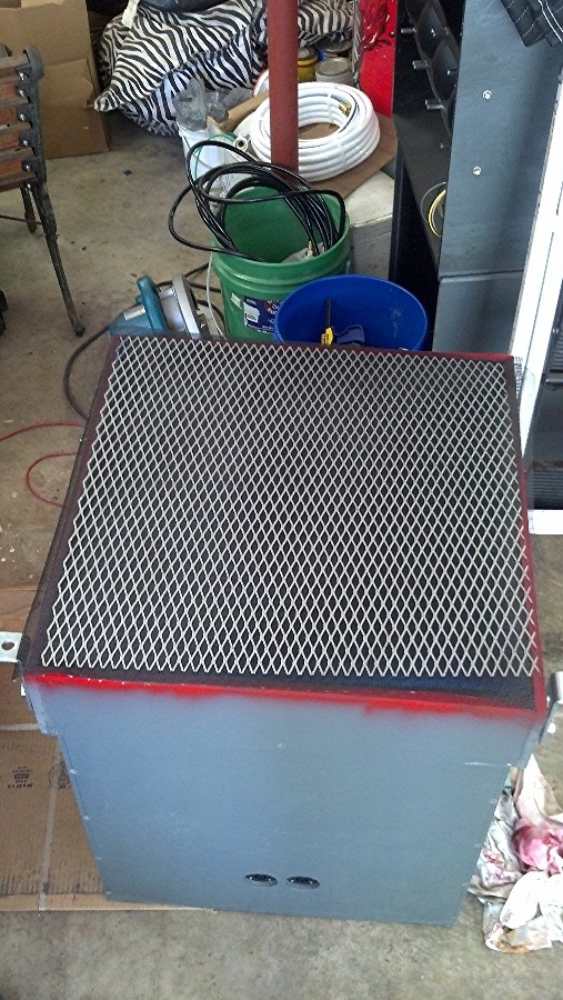

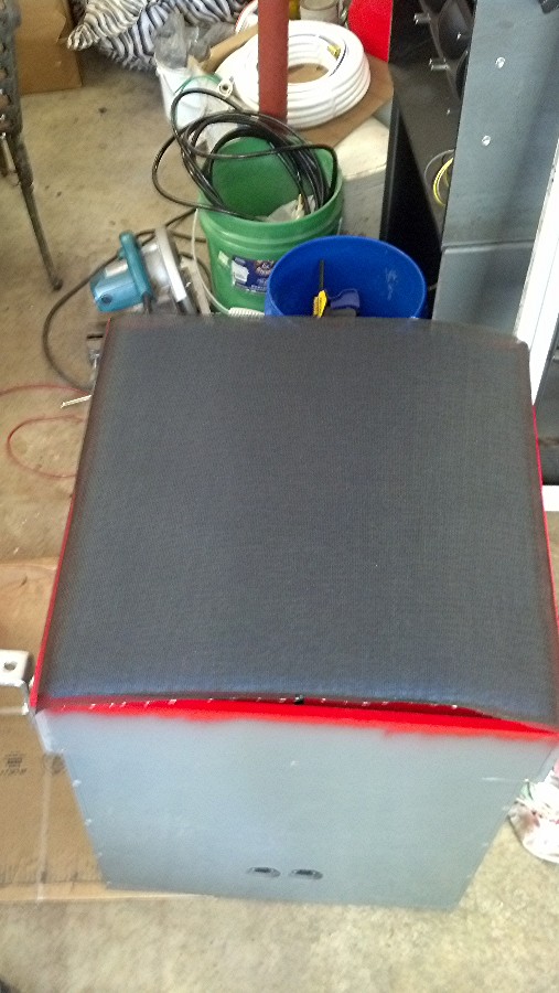

. .fourth layer one more layer of fiberglass screen . .
. .and finally, the stainless grill . .

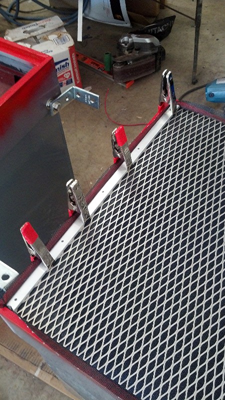

Securing the grill with aluminum bar and stainless screws . . The clamps holding the bar tight to the edge . .

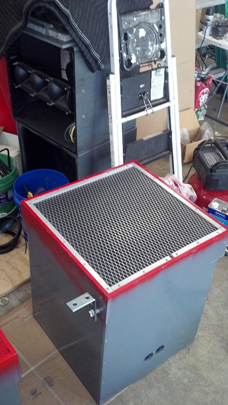

The finished look . . .
I left a gap in the bottom so that if by some miracle water ever made it past my defenses, it would have a place to drain.
The "L" brackets are the bottom front swivel attachment points and will be secured to lengths of SuperStrut bolted to the roof. I'll get more pics of the installation so you can see how it all came together . . .
