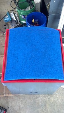

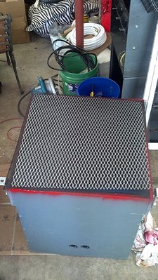

Second layer of weather protection . . 1/2" polyester filter media . . .
. .from the front . .

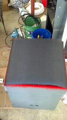

Third layer . . Pet screen . .

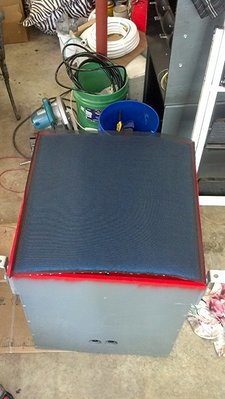

. .fourth layer one more layer of fiberglass screen . .

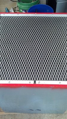

. .and finally, the stainless grill . .

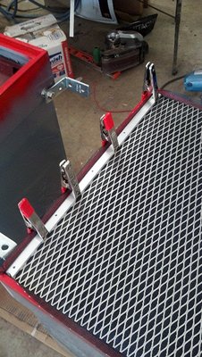

Securing the grill with aluminum bar and stainless screws . . The clamps holding the bar tight to the edge . .

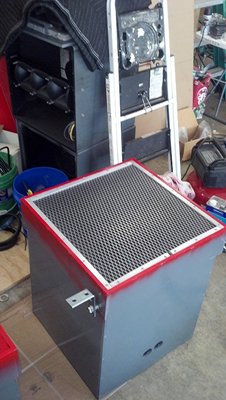

The finished look . . .
I left a gap in the bottom so that if by some miracle water ever made it past my defenses, it would have a place to drain.
The "L" brackets are the bottom front swivel attachment points and will be secured to lengths of SuperStrut bolted to the roof. I'll get more pics of the installation so you can see how it all came together . . .
Dave H

Looks fantastic. Your attention to detail is very impressive. I enjoy all the pics and detailed descriptions of what/how you do things. Digging the SS grills/mounting bars too. Where'd you get that stuff? Where do you get the sheet PVC from? I'm not building anything like this; just curious.

@mike . . Thanks! compared to the Otops, these are a breeze. You may have seen the Otops languishing in the background on that next to last pic. Not sure what to do with them . . sell 'em I guess, if I can find a buyer . . we'll see. The PVC comes from Freckleface . . . http://freckleface.com/shopsite_sc/stor ... sheet.html
The stainless grills and aluminum bar from Metals Depot . . .https://www.metalsdepot.com/index.php
