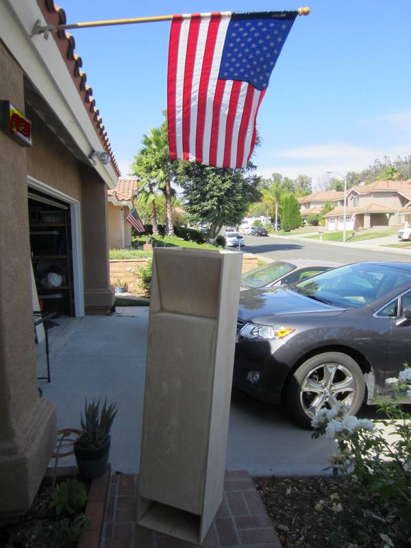

Happy 4th of July! listening to "little wing" by Sting. sounding great. still need to dial it in, but happy so far!
