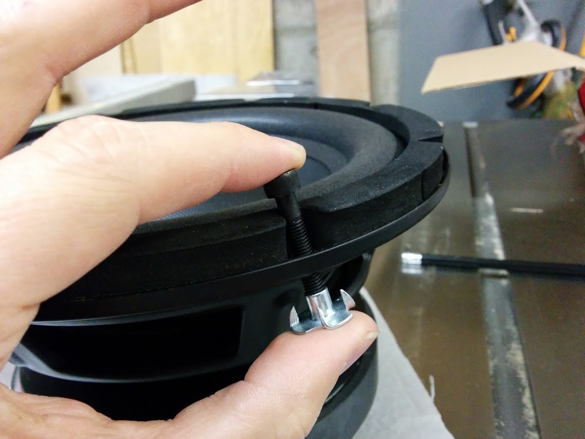

The T18 calls for 3/16" T-Nuts which aren't available in the UK. It's actually somewhere between M4 and M5, so I ordered TNuts of both sizes. I've had lots of fun with TNuts in the past when the nut isn't complete perpendicular to the hole. This makes getting the bolt in an absolute nightmare and when you are restricted on hand space, it's a real headache.
The M5 has some place through the bolt hole in the driver:
Having a look at the two Tnuts next to each other, the M4 looks a lot smaller:
