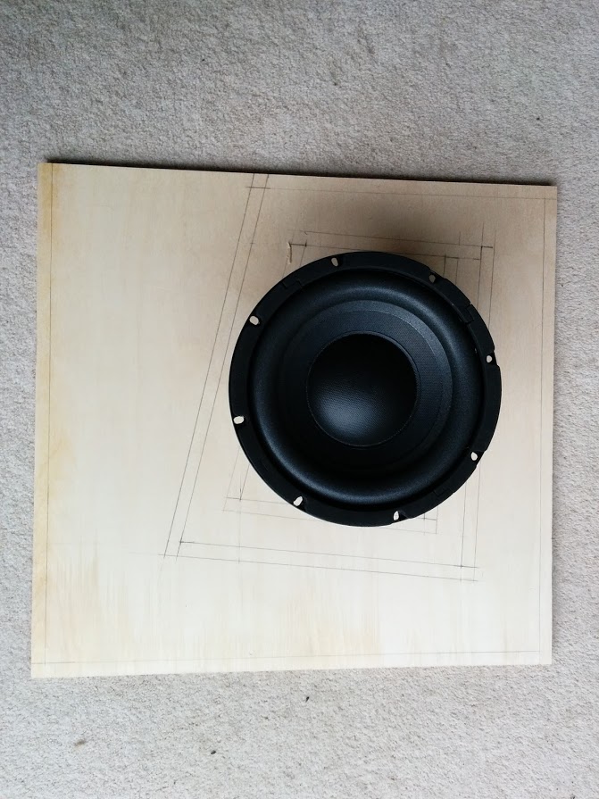

Here's a shot with the 8" driver to show you how small it is:
and here it is with a 3015LF on it!

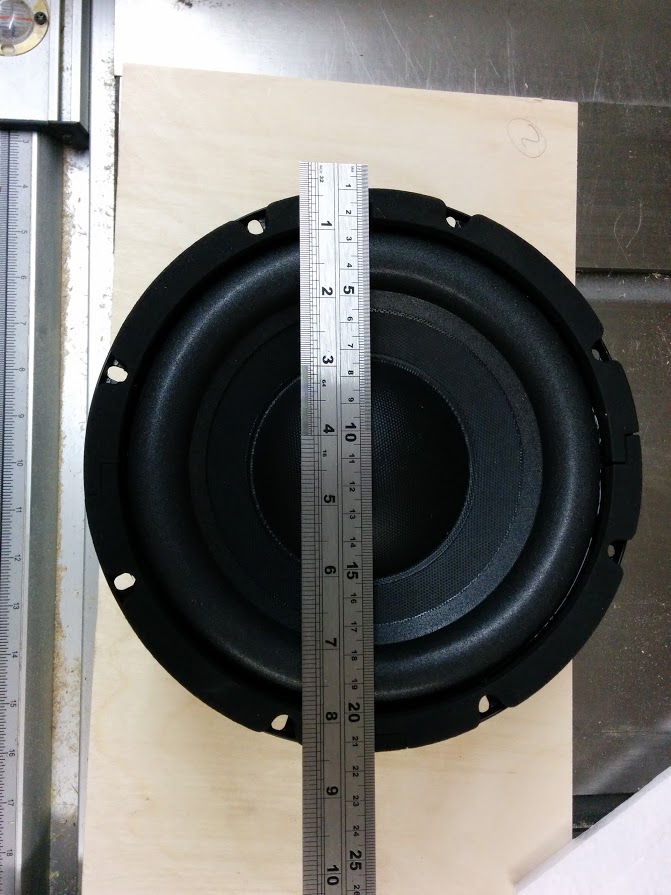

I got the driver out to measure the diameter of the cut.  It comes out at 175mm.

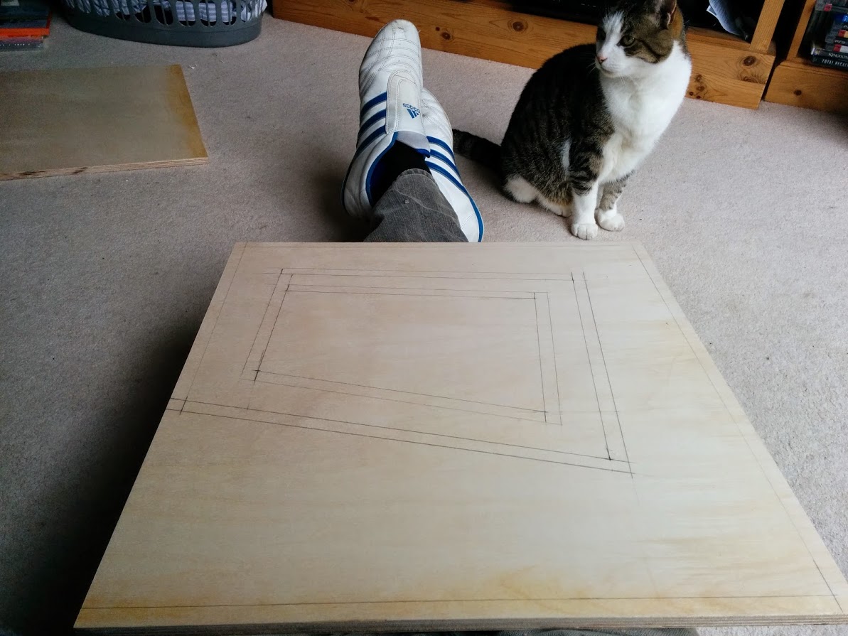

Measuring the centre point of the baffle, I got the protracter ready:
Checking the plans, I decided that cutting panel 6 was the best place to start. So I got out my angle measurer to set up the correct position, making sure that I wasn't trapping the wood between the fence:
For measuring on top of the panel, I use a steel rule to line up the blade:
I also made sure that the angled pieces didn't slide under the fence:

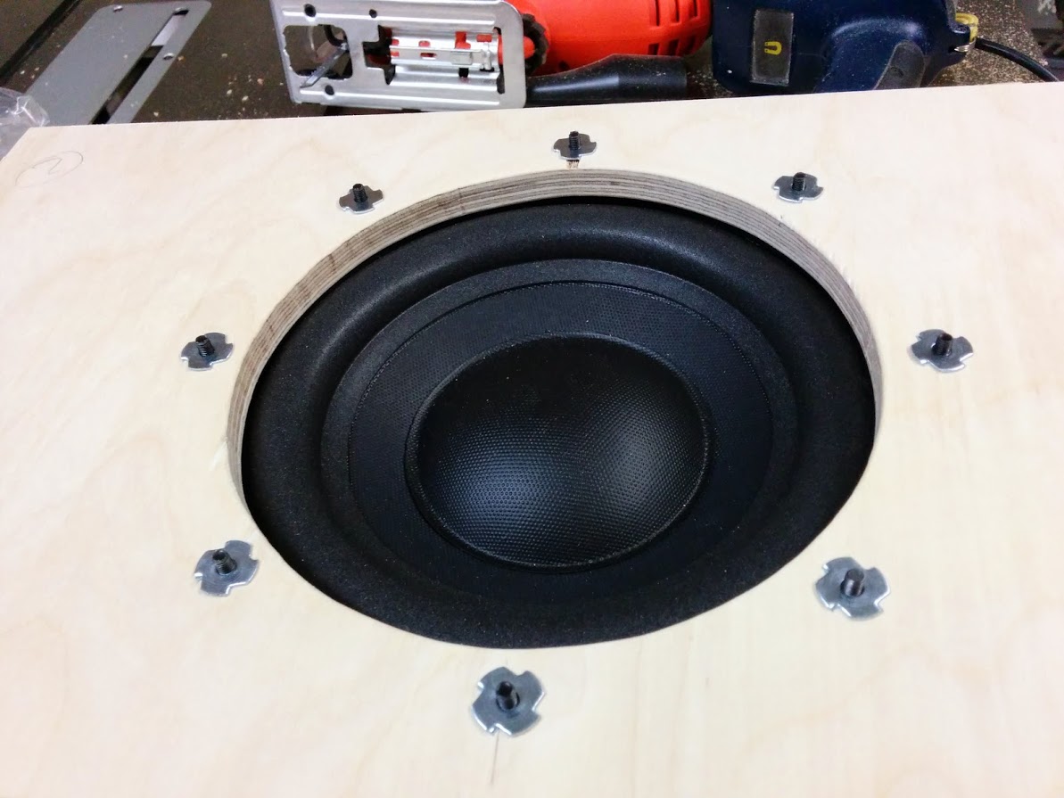

I cut the driver hole in the baffle.  No fancy tool for me, a good old fashioned jigsaw and a bit of sandpaper:
I tested pulling a tnut through by drilling a 5mm hole and turning the socket cap bolt using an Allen key. I used high quality tnuts and they pull into the birch fine:
I went round adding all the tnuts:
Drilling of the holes causing part of the ply to come away, this has created a small gap at the edge of the tnut, I'm not sure if this is going to cause a problem:
I test fitted the driver to make sure everything is ok:

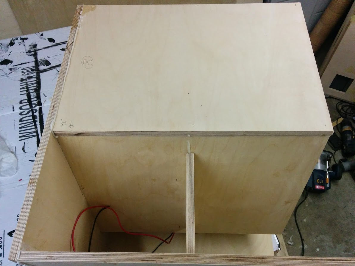

For some reason, I didn't take any pictures of the progressive gluing of the T18.  So here it is with most sides in position:
There is a mild overhang between I think panels 8 and 7 just by the top of the mouth which I need to sort. The panel ended up being 1/16" too long.
Hopefully, this will stay centred!
Tomorrow, I will remove the excess glue, cut the hole for the jack plate, paint the mouth and glue on the remaining side.
