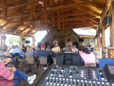

I mixed in a new outdoor pavilion last week -- a single pair of T39s and Otop12s on poles.
Wonderful sound.
