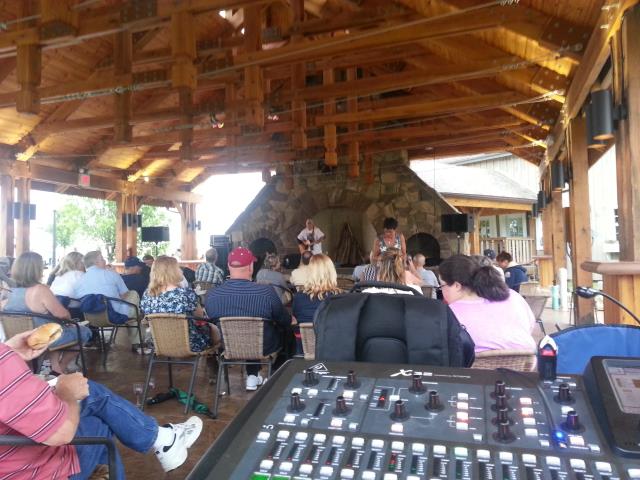

I've worked in large tents from time to time. If you can have the walls rolled up you are in much better shape. If that's not an option when it is raining for example, try to leave some sections rolled up or rolled up a foot or more. You may notice that toward the sides, where the top slopes down to the wall you get much more bass energy. I hate having a mix position near the wall.
I mixed in a new outdoor pavilion last week -- a single pair of T39s and Otop12s on poles.
Wonderful sound.
