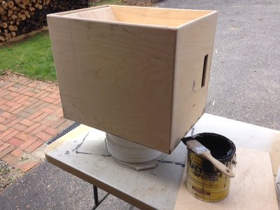

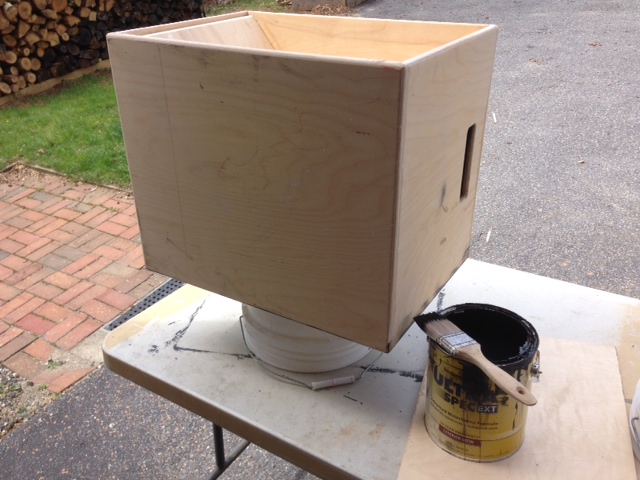

I like to be able to paint my OT12 Speakers all at one time. I am a contractor and as a consequence I have a lot of 5 gallon empty joint compound buckets around and I use them for everything. It turns out that an inverted bucket makes a nice painting stand for an OT as shown in the picture. I paint my cabs first with a coat of exterior black latex and then top coat with Duratex. Whenever any of the local paint stores have a complimentary paint offer I always buy black paint! The edge of the bucket pits perfectly inside the spacer ring on the inside of the cabinet.

Good tip Mikras.
I have many woofer circles left over from many cab builds, so I use those like you use your buckets.
