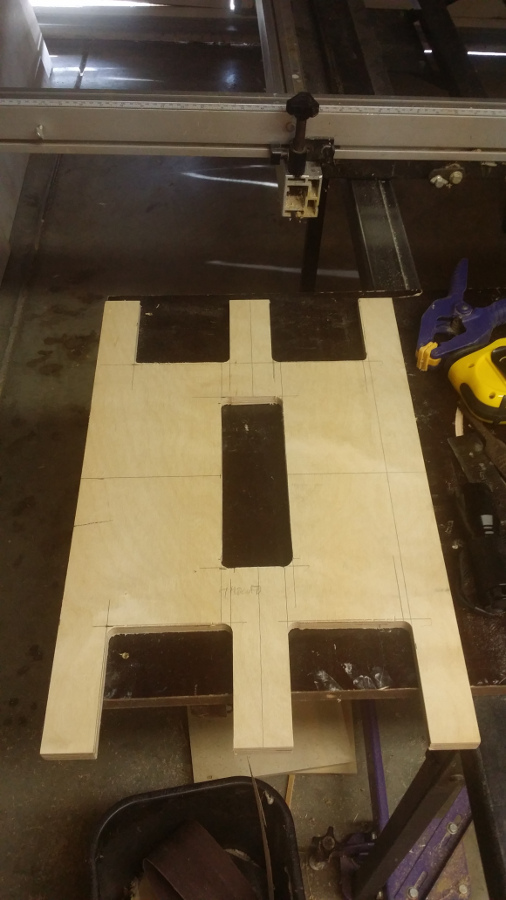

Any advice on the large rectangular holes? I figure if I can get one just right I can use my pattern bit in the router to copy it. Perhaps a rising table saw cut for the long sides and some jig saw work.

Honestly, you would need to make a template and cut the rectangles off that.billkatz wrote: Any advice on the large rectangular holes? I figure if I can get one just right I can use my pattern bit in the router to copy it. Perhaps a rising table saw cut for the long sides and some jig saw work.
Worthwhile perhaps if you intend to make more cabs, but in the similar amount of time to making a template, you could have marked up all 4 rectangles, drilled 4 x 1/2" holes in each corner, and cut them out with a jigsaw.
Also, because of the shape of the rear of the horn, you can't put both horns face to face meaning you could cut two rectangles at a time.
Just right? No one will ever see them, except for the pics you may post up here on the forum...
edit: nice work so far

I took Grant's advice that the holes don't need to be perfect, and set about cutting them. I drilled 4 corner holes, and cut the long sides of the first one with a plunge cut on my 18V circular saw. It was OK, but not as straight as I wanted. I cut the long sides of the next one with a rising table saw cut. This worked very well, and I used it for the remaining cuts. With a calibrated fence the cuts went quickly.
Then I finished the cuts at each end with my jig saw, cutting the ends of the long cuts and the short cuts. You can see the cuts are not perfect as they meet the holes, but I hope this is good enough for these inside holes.

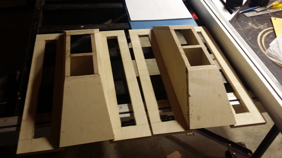

I made some progress this weekend. I squared up the horns, and tacked in the center support: Then I put the remaining ends on, and cut the angles at the top and bottom of the assembly after the glue set up.
Then I started working on a pattern/jig for the two 4" square holes at the top and bottom of each baffle. Since there were 8 identical cutouts to be made, and I can see the the audience here likes things tidy

I finished the baffles, using a template and router for the 4 larger openings on each, and a circular saw and jigsaw, and being very careful for the central opening. I used some scrap pieces to alight the horn front and the baffle - thee 3 degree cuts lining up perfectly.
Here is the horn all clamped up:
Both horns are finished, save for the woofer spacers, which I can't complete until I order the woofers. Next task - lay out the design on the top and bottom of the cabinets, and fabricate the horn sheath braces. I can see how getting the horn sheaths on will really be a huge step toward making it look like a speaker cabinet!
