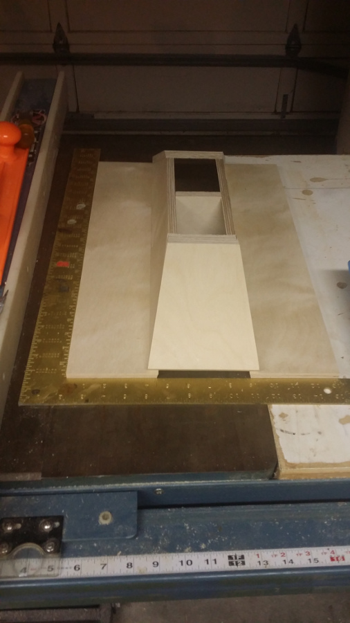

I made some progress this weekend. I squared up the horns, and tacked in the center support:
Then I put the remaining ends on, and cut the angles at the top and bottom of the assembly after the glue set up.

I finished the baffles, using a template and router for the 4 larger openings on each, and a circular saw and jigsaw, and being very careful for the central opening. I used some scrap pieces to alight the horn front and the baffle - thee 3 degree cuts lining up perfectly.
Here is the horn all clamped up:
Both horns are finished, save for the woofer spacers, which I can't complete until I order the woofers. Next task - lay out the design on the top and bottom of the cabinets, and fabricate the horn sheath braces. I can see how getting the horn sheaths on will really be a huge step toward making it look like a speaker cabinet!
