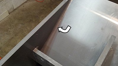

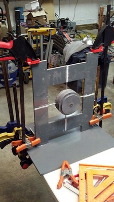

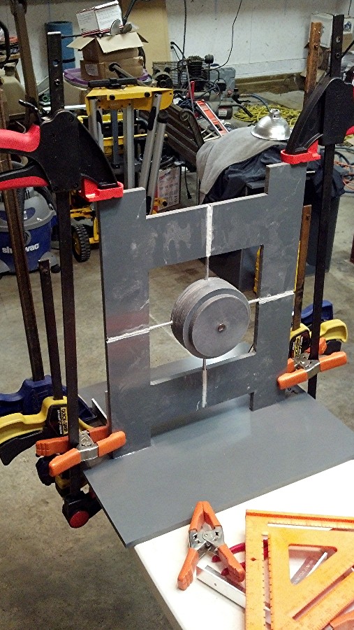

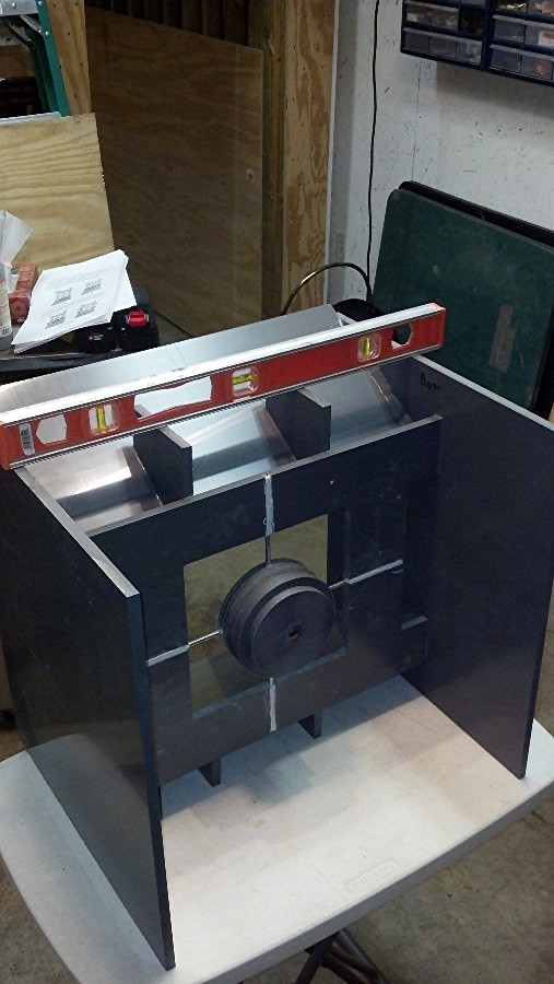

Weather is FINALLY coming around and I'm behind schedule . . So, number 2 of the four Otop 15 build out has started.
For those not familiar with what's going on, here's the original thread . . .
http://billfitzmaurice.info/forum/viewt ... 30&t=20952
Here's what I got done yesterday on #2 . .
Pay no attention to the bubble . . I was simply making sure the braces matched the top and bottom . .

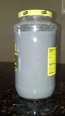

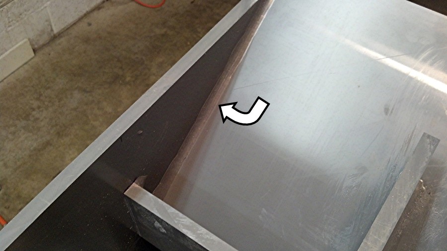

The goop I made from PVC wool and MEK/ Acetone for caulking the seams . .

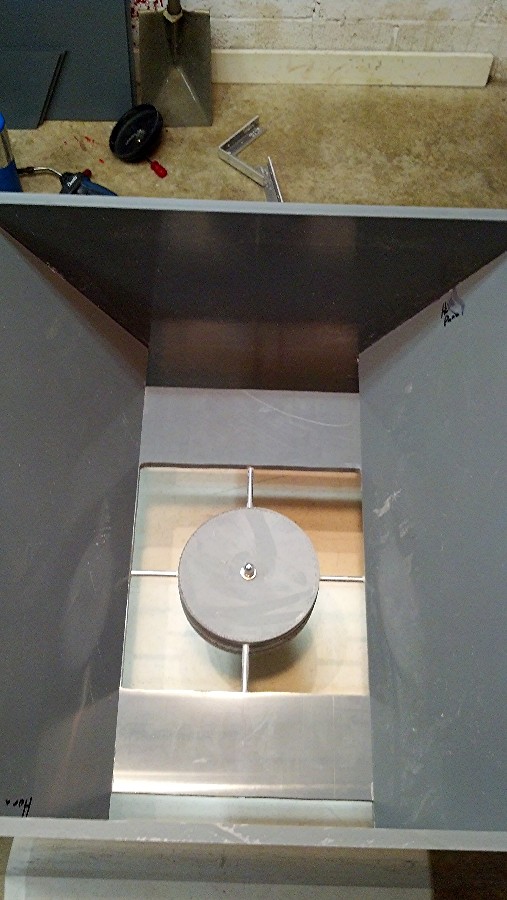

. .and the seams . . .
Dave H

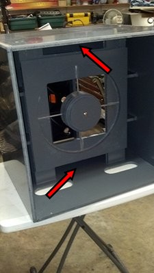

I do have one question . . I've attempted to spy it out on other Otop builds, but just to be sure, you do put damping material inside the top and bottom baffle openings to the throat deflectors . . Correct?
Dave H
Re: Weatherproof Otop15, part Deux
#3 Post by Grant Bunter »
Hackomatic, I think the answer to that has only appeared in one thread, where the damping material was beginning to encroach on the openings.
IIRC, Bill said to keep the damping material 5cm/2" away from the openings...
Posts: 29097
#4 Post by Bill Fitzmaurice »
Hackomatic wrote:I do have one question . . I've attempted to spy it out on other Otop builds, but just to be sure, you do put damping material inside the top and bottom baffle openings to the throat deflectors . . Correct?
You may, but it's not a necessity.

Bill Fitzmaurice wrote:You may, but it's not a necessity.
By that I assume you mean no advantage or disadvantage . . .
More of a may not help but can't hurt.

#7 Post by Hackomatic »
Then a dab o' poly goes in. 8)

#8 Post by Hackomatic »
Okay . .I'll be putting the Polystuff in the horn and deflector areas, but as far as the rest of the cabinet lining material I'm staying away from any foam products because of their propensity to degrade/ disintegrate over time. .especially in an outdoor setting. I "think" I have a source for bits and pieces of 1/2" felt carpet pad. If that should fall through, is 1" mineral wool or 1" EcoCore board an acceptable substitute? Didn't know if the thickness was a concern . .
