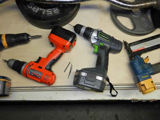

Got my artillery ready,i also have some of the right angle jigs in my truck,i use them to angle my DR's.

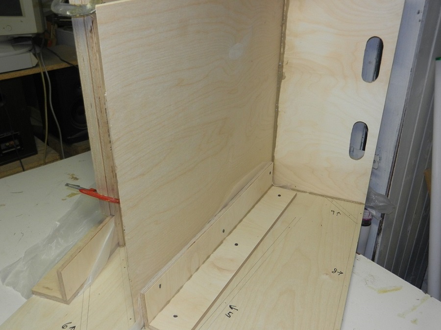

I didn't get alot done today,i had some other things that needed tending to.I got panel 1 installed,starting with the panel 1 jig installed with waxed paper:
Panel 1 installed
Panel 1 topside
I got the anchors installed in the baffles
I decided to wait until tommorrow to install the baffles to give my right angled jigs time to dry.
I'm gonna try to get panels 2,3, and 4 installed tommorrow.

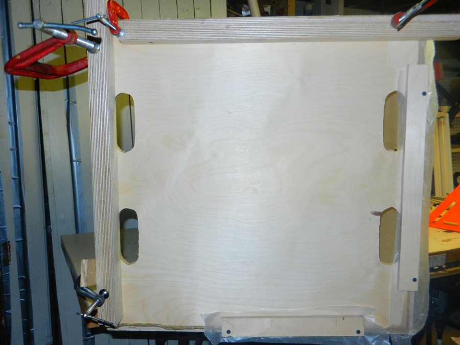

I made a little progress today with extra emphasis on getting the first 4 panels as square as possible.
Whatever progress i post is of both cabs.
Here's the baffle dry fit: Baffle installed,sloppy glue joint,the panel wavered as i was putting it in place,thus the sloppy glue joint.I just added more PL without smoothing it. close up of the joint On the other cab's baffle,i clamped a piece of plywood where the Baffle would be installed,leaving about a 1/8 inch gap as a guide so the panel wouldnt waver as it was being installed. And that joint came out much better

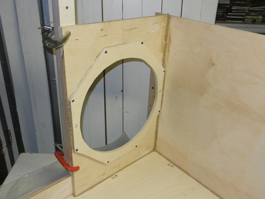

More progress.
Panel 4 installed Panel 5 dry fit Panel 5 dry fit view 2 I like to add braces first then install the panel,trying to slide them in place doesn't work for me,just a waste and a mess of PL Panel 5 installed,as well as the 4/6 brace,thats it for today,i should be able to install panels 6,7 and the flanges and braces for the front of the cab tomorrow.If anybody has noticed,i have attempted to use scrap plywood and guideboards in the exact area's as they are in the plans,i have been reflecting on something Bill said,"even after building 100's of cabs i find the results are best when i knock off only a few steps a day".Then there's DJPhatman,"accept the fact that airtight and well braced..."And i must admit,these are the squarest cabs i have built.i have placed a "W" caul on the 4/6 brace and used a 12" inch guideboard to hold it square until the glue dries.there is 1 screw screwed into the brace from the inside to hold it in place until the glue dries.
I forgot to add panel 3's picture,iwill add it on the next post.

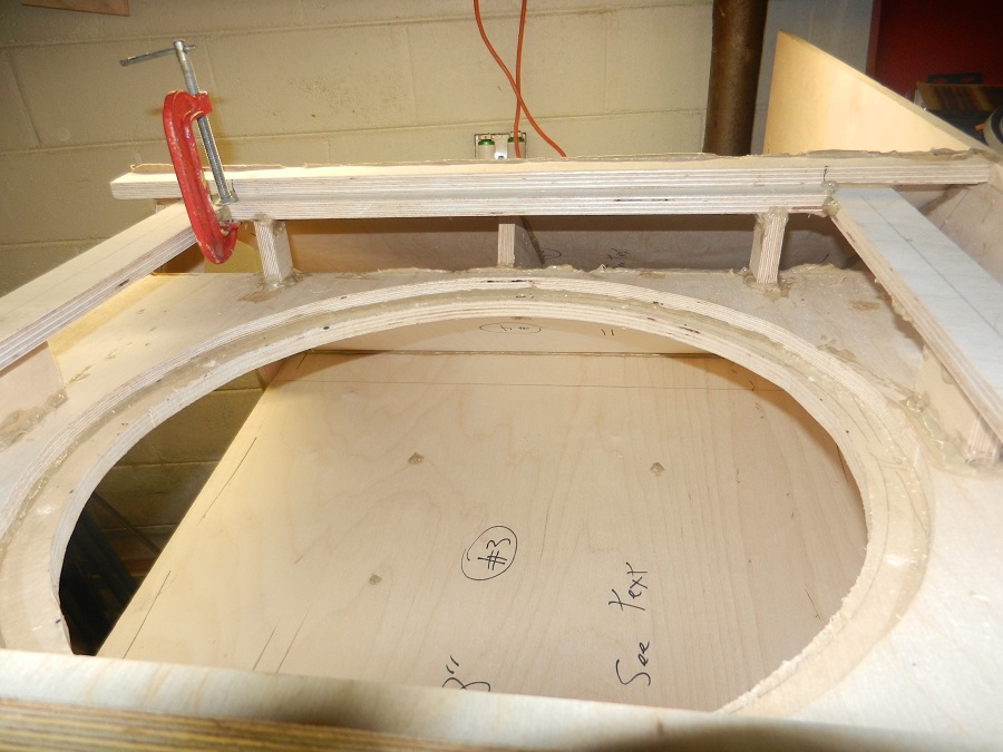

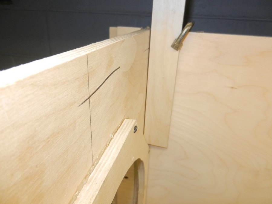

I do something similar for this and other situations to line things up. I keep a bunch of cleats cut up from scrap wood. Wrap them in plastic wrap or wax paper, shoot them right against the pencil line with 5/8" brads. Strong enough to let you hold the panel against them while shooting through the other side, once secure they pop off easily.djtrumptight wrote:

I just used the caul long enough to shoot brads in the panel then remove it,thats why it had no waxed paper on it'
Access panel flanges installed. Access Panel flanges installed side view Baffle and flange braces installed,view from cab top Panel 7's installed I have my backs and bottoms prepped already,hand holds cut out,the only cutting left to do is 1 set of back braces,1/2 inch off the bottom panels and the access covers.Im gonna try to do the backs,back braces,panel 10 and possibly the mouth braces today.That will allow me to get a break for a couple of days until my hardware comes in from Leland
