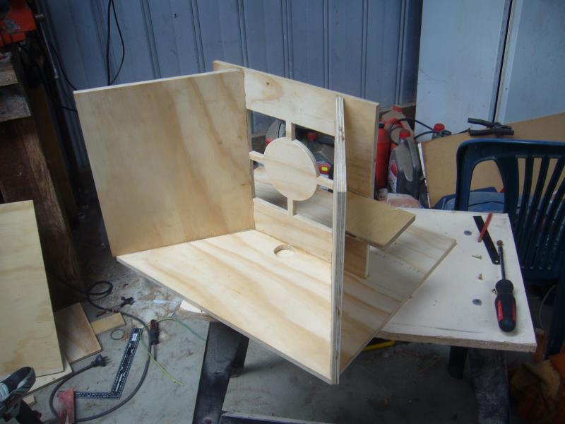

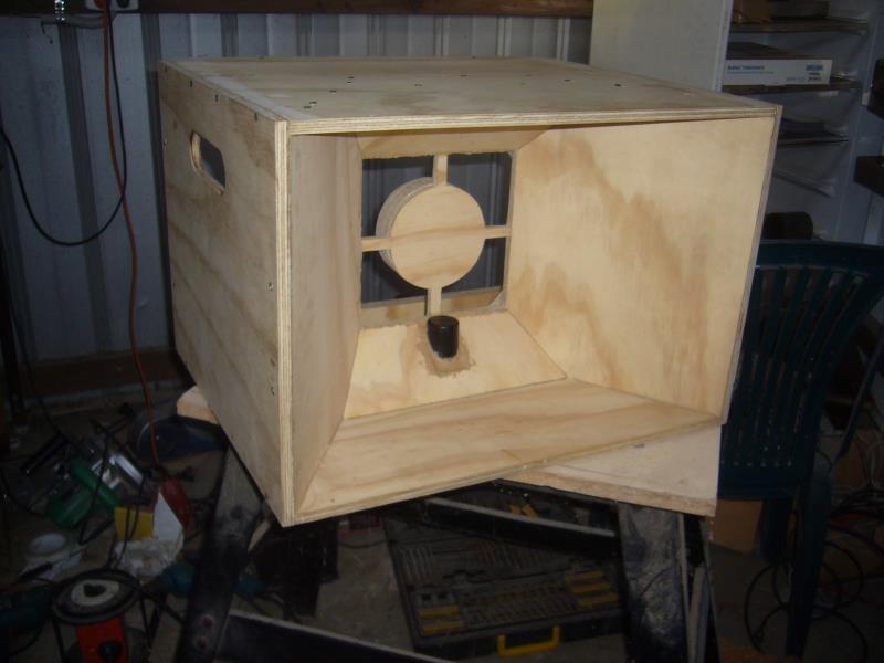

Re: OT12 - Beta12 build + T48
A few build pictures of OT12's
