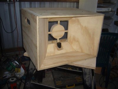

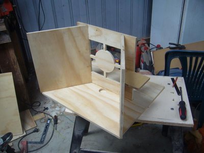

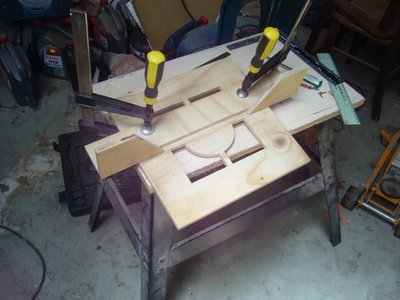

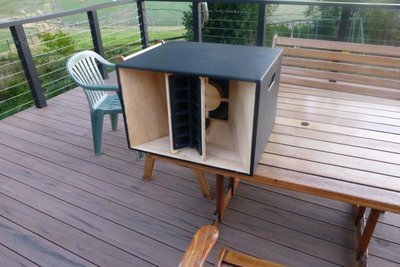

#15 Post by Chompy191 »
A few build pictures of OT12's
