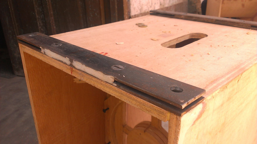

Hey guys,
We are back with some progress pictures. We applied hot melt glue to the possible leak points around the baffle to keep the cab air tight. Please see pictures below.

Below are some progress pictures of the cabs with the flying hardware fittings. Some acrylic primer was applied to places that will be difficult to reach once hardware are installed,

The pictures below basically shows the flying rig design and fabrication process.

More test fitting flying hardware pictures.

#56 Post by Grant Bunter »
cave wrote:
88h88 wrote:Looks like some pretty serious hardware...
I believe diyers could do even better with just a little support rather than the discouragement we usually face trying to perfect our products. I found this system and decided to enhance and adapt it to BFM cabs. Looks good and working well so far.
I don't think the comment was intended to be critical.
At least here in Australia, I don't think your method would satisfy the engineering requirements required to fly PA.
The main reason being that Bill's designs are engineered for sound quality/output, not engineered for structural integrity for flying.
In order to meet structural integrity for flying here, the cabs would have an integral steel frame on the inside of the cab so that, if for some/any reason the cab decided to fall apart, none of the pieces would fall to the ground as they are held firm by the integral internal steel framework.
A number of brands of commercial cabs are designed to be flown, but can only be certified to be flown by an engineer in the country they will be used. So it doesn't really have anything much to do with the fact the cabs or the rigging are DIY.
Another method that might satisfy the requirement here would be that the cab sits on a frame on the bottom side of the cab, ie the cab is held up without relying on the structural integrity of the cab.
Of course, around the world, the whole reason that safety has become an issue in PA over time is simply one of to many things falling down that have been lifted up, and to many times people being injured as a result.
Whatever you do, I urge you to investigate your local laws about rigging and flying cabs, and if applicable, have an engineer certify your method.
After all, it will be you that ends up having to pay should anyone be injured.

Hi Grant Bunter,
I actually took 88h88's comment as a compliment. I just was saying that encouragments will serve us better and make diyers strive to improve.
I have steel plate inside the cabs to hold cab and outer steel together. Your advice is well noted and will go a long way to improve the hardware for the DR250. Thanks
