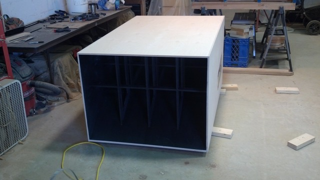

Is it a problem when the outermost brace at least partially blocks the driver from the outside panels?
In other words consider the attached image. Basically the solid outermost braces constricts the expansion(except to the rear/front).

tpgreen wrote:Is it a problem when the outermost brace at least partially blocks the driver from the outside panels?
No, the wave will go around them.

That's a big effin' speaker you are making there :) Please post a build log as you go ;)

escapemcp wrote:That's a big effin' speaker you are making there :) Please post a build log as you go ;)
Actually, this is a big effin speaker - a dual 12", 39" T60.
Putting the THT together feels like assembling a bookshelf speaker after building the mighty T60.
