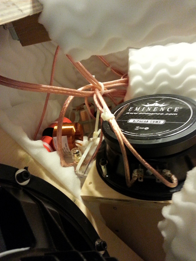

As promised, if anyone is still interested, here are some photographs of the inside of Box 1 of 2.
Omni 15 Tallboy in the 2-12" configuration at altitude :lol: :
OK OK here's just the box:
And here is the low-pass filter connected to the woofers:
And here is the midrange bandpass filter with the midrange, kinda hard to see the filter board:
The high pass filter:
And for completeness, the next post will feature the kindly plain inside of the removable back access panel.

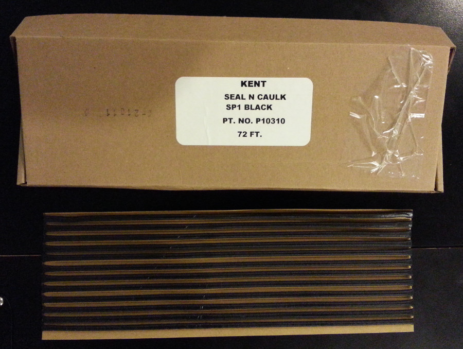

Here's the "tar-like substance" I finally used to fully seal the drivers and horn where they meet their mounting boards:
This is nasty sticky stuff but it creates a great seal. Here's what it looks like before the driver is mounted:
When the driver is mounted the material squishes out, and care must be taken to make sure it doesn't interfere with the surround.
Both 3012LFs, the Alpha6A-CBMR, and the Selenium HC23-25 horn got this treatment, and there is no detectable leakage at all around the drivers now, nor anywhere else around the cabinet.

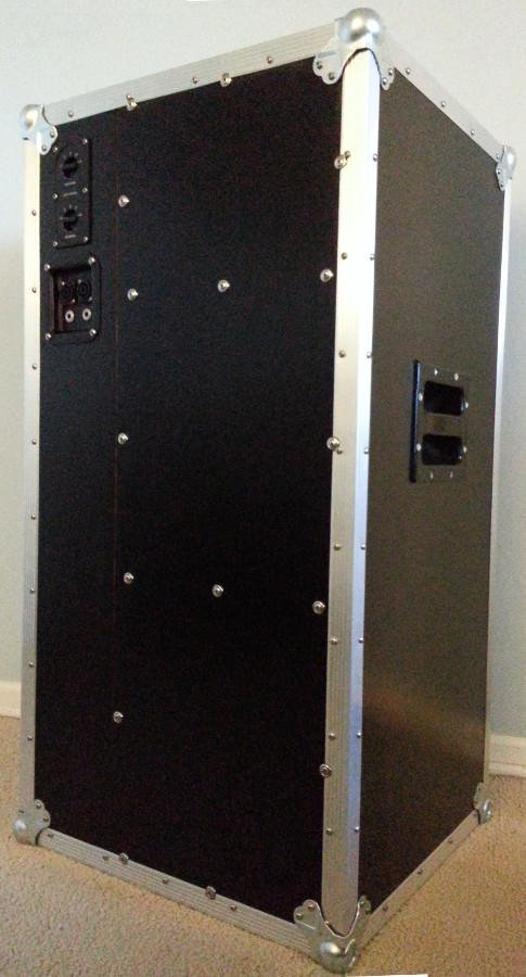

:hyper: Box 1 of 2 is complete! :hyper:
101 pounds (45.9 kg) of robust gear. It's always good when the product meets or exceeds the vision for it. I think we can safely say that this compact speaker system outperforms a legacy JBL 4663 (based on a Perkins bin), at significantly lower weight, and in a significantly smaller space, than the JBL.
And it looks exactly like what I had in mind from before the beginning, when I hadn't yet heard of Bill Fitzmaurice or this community.
Now the following pictures were taken inside in low light conditions and are not particularly good, but they show the current state of the project. It's cold here, at least to me, and a few minutes spent trying to get photographs outdoors convinced me to move inside. The grille is black Mellotone cloth.
