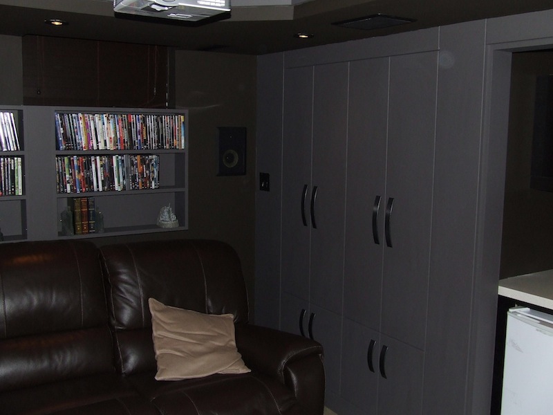

Hi Shawn here's a few pictures of the Home Theatre (Sorry if I'm hijacking this thread)
Cheers
Stuart

Very nice! I'm jealous. :mrgreen:
