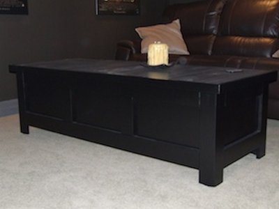

Hi on mine I just laminated over the the speaker box with 1/4" inch ply and used poplar for legs and frame

I also went the 1/4" ply route. Nice looking build you have there!Stuart wrote:Hi on mine I just laminated over the the speaker box with 1/4" inch ply and used poplar for legs and frame

shawn_g wrote:I also went the 1/4" ply route. Nice looking build you have there!Stuart wrote:Hi on mine I just laminated over the the speaker box with 1/4" inch ply and used poplar for legs and frame

Hi Shawn Thanks though I have to admit that I borrowed your idea for finishing it off

Well it looks great. Do you have any more pictures or a build thread? I've been thinking about building a new coffee table.Stuart wrote:
Hi Shawn Thanks though I have to admit that I borrowed your idea for finishing it off.

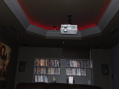

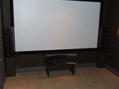

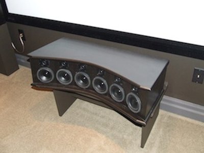

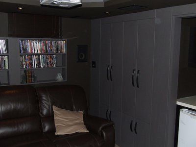

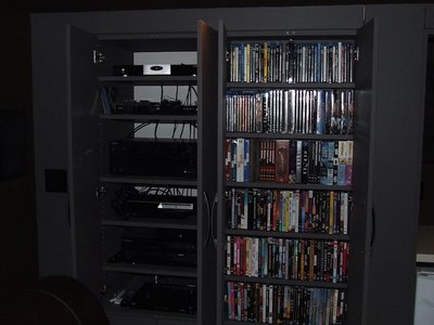

Hi Shawn here's a few pictures of the Home Theatre (Sorry if I'm hijacking this thread)shawn_g wrote:Well it looks great. Do you have any more pictures or a build thread? I've been thinking about building a new coffee table.Stuart wrote:
Cheers
Stuart
Cheers
Stuart
Re: TT Cabinet
Very nice! I'm jealous.

When I mount my project screen again, I was considering mounting away from the wall so the left, right and centre could sit behind the screen. I'm not sure what effect this would have on audio quality.
Re: TT Cabinet
From what I have read on AVS, the Moleskin Spandex slightly dulls the highs.Chris_Allen wrote:When I mount my project screen again, I was considering mounting away from the wall so the left, right and centre could sit behind the screen. I'm not sure what effect this would have on audio quality.
