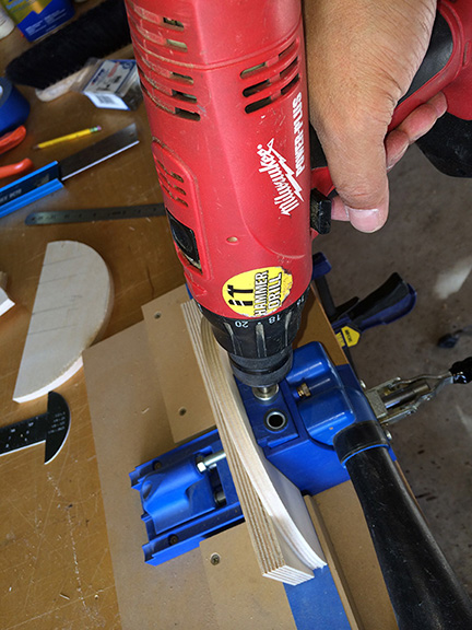

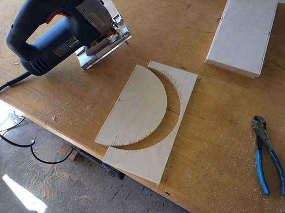

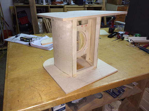

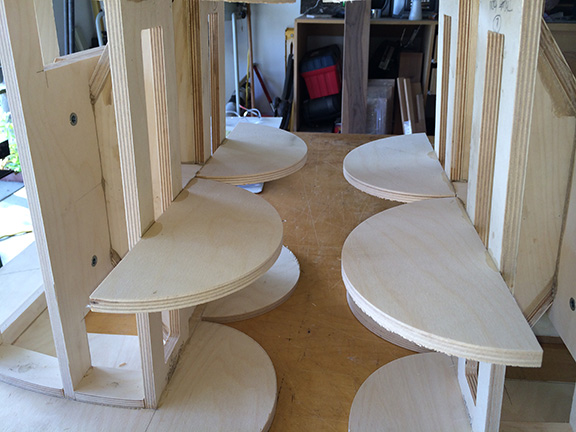

(Cont.) Now for the back braces. Since I've already made a cutting jig for the tops and bottoms, I used the same jig to cut out the back braces, since they are the same radius and shape.
For a more sturdy connection, I used a pocket hole jig to assist in making the joint mechanically stronger.

 Re: Journey - DR200 Build
Thank you for the detailed pictures - this is the best explanation I've seen of how to make these little pieces.

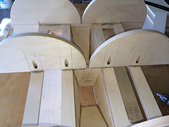

(Cont.) Next up was to cut and install the drive chamber sheaths.
Each were rough cut as per the plans and then trimmed to fit and installed. I elected to use crown staples to hold it together. Once the PL dries, I'll fill all the holes and sand smooth.

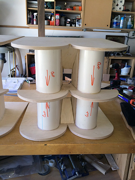

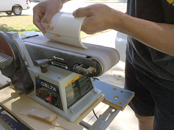

I did the same with the crown staples.
I used Bondo brand glazing putty to fill in the voids left by the staples. It dries fast and sands easy.
Just a tip. When you get to the point of installing your PVC pieces make sure you ruff up the area's on the PVC where the hot glue will join them to the cab. If not the hot glue will not adhere to the pipe very well.
I used a 1" belt sander to make a filet on all edges of the PVC and a hand sander to ruff up the edges of the PVC for the hot glue to bite onto. Once the glue has cooled a sharp chisel takes care of any extra glue on the joint.

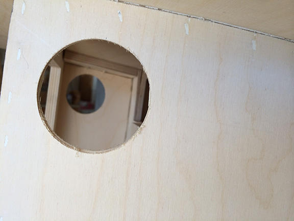

Today, I cleaned up the PL squeeze out where needed and filled and sanded all the staple and screw holes where required. Then time for the PVC installation to finish up the driver chamber. I got the PVC part precut to rough length from speaker hardware.com. Since the 3 degree was already cut, I just trimmed to size on the 90 degree side with the table saw. Today the humidity is 6% in So Cal, so the static electricity was high. Couple that with cutting PVC, made for an electrifying and shocking time!
I trim cut and dry fitted all the pieces. I marked each one for their respective places. You'll also notice that I marked the (90 degree) end to trim off. It's SO easy to cut off the 3 degree end since it's so close looking to 90 degrees. Here they are all dry assembled. Side view. Using biggerrigger's advice, I used the belt sander to chamfer all the edges along the sides and ends to get a good gap for the hot glue. More static and dust. Sanding the long edges.

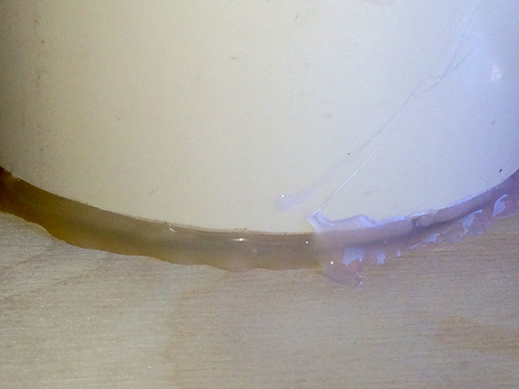

Sanding the other long edge. Getting at the ends. Lots and lots of hot glue. With all the PVC pieces glued in. I remember one of the things I don't like about hot glue... all the "spider webs" that you have to clean up. I was getting ready to start on the Melded Tweeter Array section, but during the rough cutting, the table saw decided to catch one of the pieces and fling it back at me. It hit my thigh pretty good and tossed me back a couple of feet. Felt like someone hit my left thigh with a baseball bat. That's gonna leave a mark... well a bruise anyway. After that, I decided to call it a day, before I do any more damage to myself. Can't wait to see how it's gonna feel tomorrow.

Glad to hear it did not go any worse with the table saw. I have caught a large piece of kick back right in the guts and can tell you it was no fun at all. It took over 3 weeks for the bruising to go away.
On a brighter note your PVC looks spot on. That is exactly what I was talking about.
