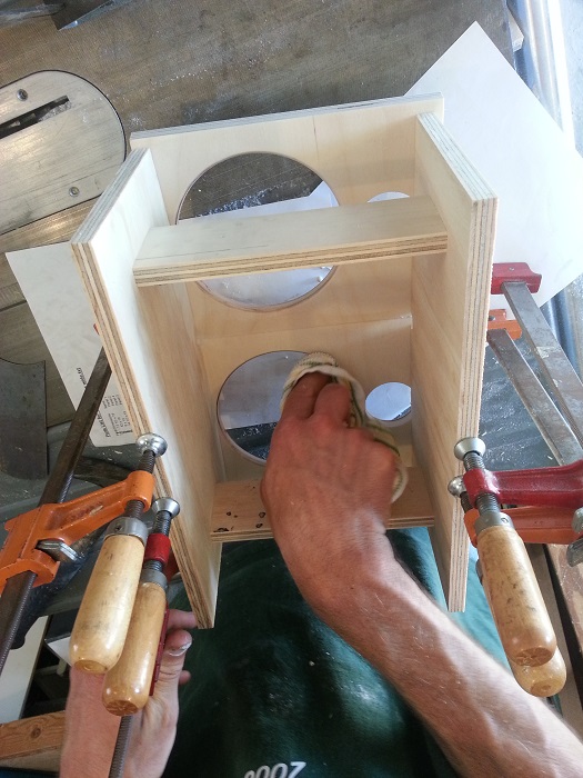

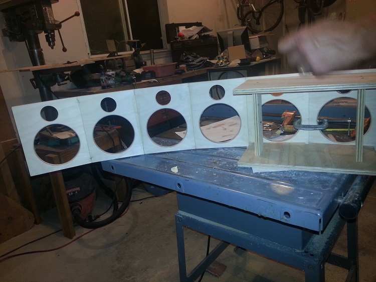

Now to the pictures: I trimmed the edges after this picture but the other picture turned out to be a blurry mess so here is the baffle standing on top of the table saw (not glued yet) Looking absolutely flush there I might say
