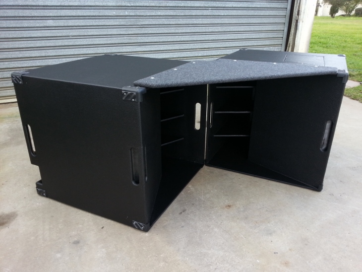

Hey, a handle, what a great idea! If it's not sapping any power, no drama. Vaporwood...mmm, yes please!

Chris_Allen wrote:
Keryn O'Shea wrote:Yes that's it! A laminated v-plate would definately be stronger, but heavier? Is a brace inside the horn path going to affect anything? One could be fitted to the top, just have to rip the carpet off!
Adding a brace won't do anything noticeable but if the cabs aren't flexing, there is no need.
You could either add another sheet of ply to your VPlate or if you are worried about the 100% increase in weight, some strips of wood (maybe 3/4"?) with the ply running at 90 degrees to the top (are they called ribs?), should be enough to stop the flexing though they would be fragile in transport.
Glass fibre matt and epoxy resin sheathing adds massive stiffness to any piece of plywood, if one has it to hand. At the cost, it's not worth getting in, unless one is going to attempt a 6mm thick ply T30 build and sheath all thru, with 3012LF's. Would need to test stiffness of 6mm sheathed against 12mm BB non-sheathed. Oh dear, must stop!

Good job, Keryn!
BTW, is that a single caster wheel cut-out?
Keryn O'Shea
Posts: 634
Location: Brisbane, Australia
Re: Read the plans, and look at the right sketchup!
#39 Post by Keryn O'Shea »
Thanks Tom! The cut-out you can see is for the jacks which are mounted on panel 10, the castors are mounted to 12mm backing peices on the back panel, I wanted more ground clearance than the plans castor positions gave, to help save the finish over rough ground.
