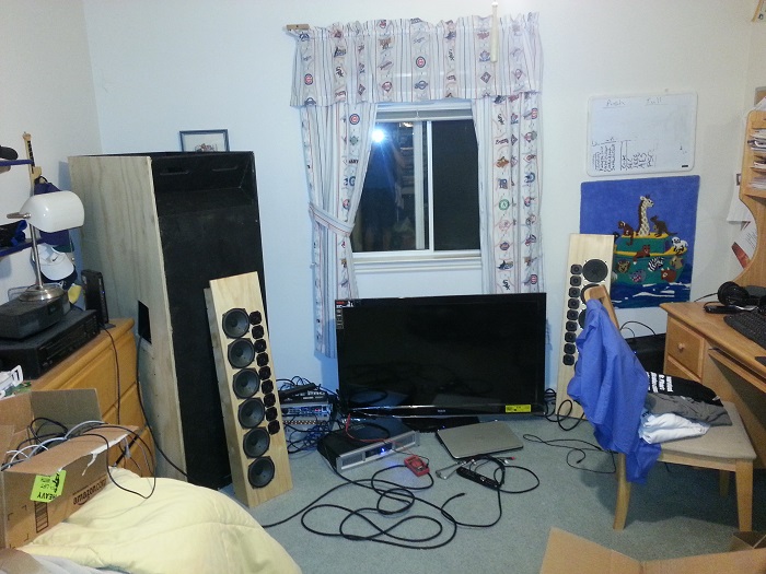

Here's a picture of the sub in my room.  For those who don't know the speakers are TLAHs at 40 inches (standard) and that's a 46 inch diagonal tv...
In other words, if you're planning on building one of them, know what you're getting into .  It just barely navigated the corners getting into my room.
