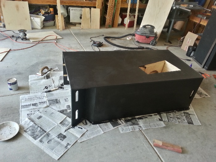

Painting mouth, going to touch up once braces are in. Note that the specs are dust and are now vacuumed out.

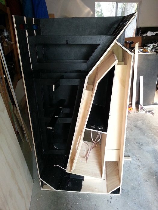

Making braces like the pro's (well... trying)
First, installing panel 12 and de-warping it with quality screws.
Panel 12 glued and screwed
Braces time!
The tall front braces will be made tomorrow (and the rear long braces will get painted/sanded/bondo/etc..)

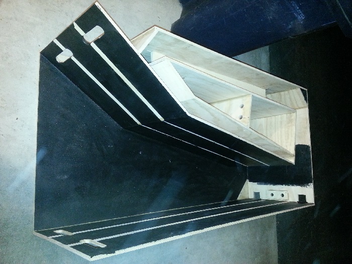

Rookie mistake: shook paint can before making sure the lid was sealed tight, managed to splatter all over myself and the garage (good one Will). After that things got better though. I'm discussing with my dad the best way to make the single piece glued double thick access panel flanges. No air leaks at the moment, PL squeeze-out everywhere. You guys don't know how anal I'm being with my joinery but I swear if this one has any leak issues the speaker gods hate me. Installed panel 13 and rear braces.
Side panel painting
Panel 13 glued and 1 screw + 1 clamp.
Braces installed, touch up painting will be tomorrow

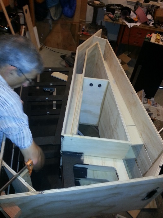

Just painted horizontal braces and front braces. Glued together baffle flanges (double thick carved around driver backer). Hoping to get all the internals airtight and tested. Going to try a ground breaking seal testing technique. I'll post when I a have results.

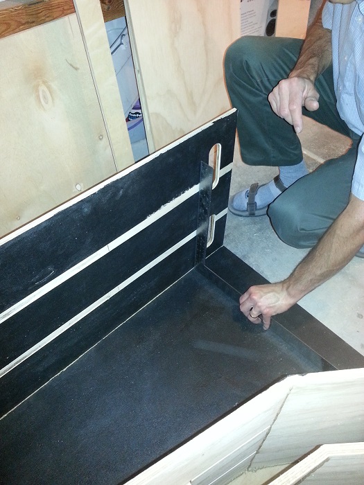

Put on the final side tonight. All that is left is install the driver, leak test, install the access panels, leak test. Then finishing + wheels, etc...
Just wondering, what SPL should I expect in the first (no access panel) leak test at 1 W?
Glued and Screwed
Adding weight to ensure the entire panel is flush with my PL and all the invisible areas are squeezed out.
Yes those are our extra bathroom tiles and a concrete block.
