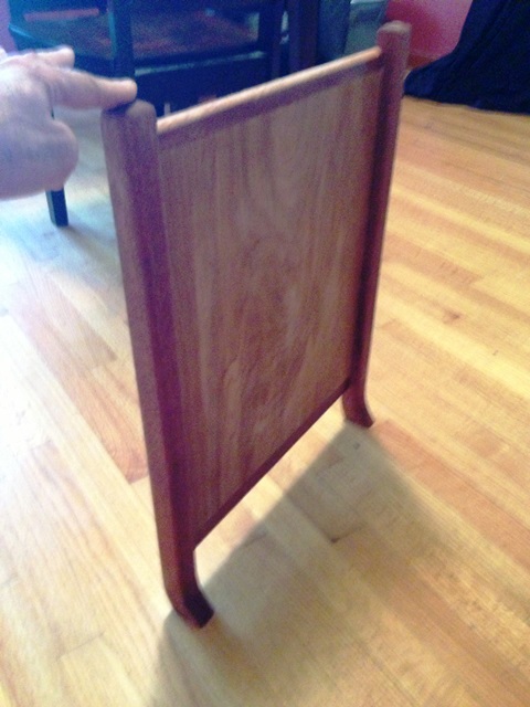

Here is a picture of the sides that I am talking about. Looking at the front of the sub, the width is fine, the height is only 1/16' too short but the depth of the sub (front to back) is 3/4" too narrow.
As you can see in the photo with the layout lines, I was using the original sizes of the internal parts.. but due to the fact that the panels are too narrow, the passage ways on the outer ring.. would be 3/8" too narrow on each side as the entire side piece is 3/4 too short.
My only thought is to reduce the size of all the internal components that establish the depth of the sub by 3/4"... those would be the horizontal layout lines in the photo.
Make sense?
The last photo is the media cabinet I made for the same friend. Different wood species (curly maple and bubbinga) as opposed to birch and sapelle on the sub. But I wanted to mimic the same style with the curved legs and opposing color woods.
Thanks for any input!!

Bbieger wrote: My only thought is to reduce the size of all the internal components that establish the depth of the sub by 3/4"... those would be the horizontal layout lines in the photo.
Since the die is cast that's all you can do.

Thanks bill. You think that is going to really be a detriment to how the sub sounds? I realize that it's less than ideal and you can't imagine how angry at myself I am, but at this stage is it realy worth cutting the legs off, going to the hardwood store and starting all over?
Posts: 29056
Re: Tuba 18...oops
Bbieger wrote:Thanks bill. You think that is going to really be a detriment to how the sub sounds? I realize that it's less than ideal and you can't imagine how angry at myself I am, but at this stage is it realy worth cutting the legs off, going to the hardwood store and starting all over?
Compensate for it by going as wide as you can.

Roger that. It's 17" wide, which was the widest recommended for a single driver.
I'll guess we will see

Bbieger wrote:Roger that. It's 17" wide, which was the widest recommended for a single driver.
If you haven't cut them yet add another inch.

Would you be able to sand the "trim" flat with the panel, and then use part of the "trim" as your panel? I realize that it probably wasn't what you had intended, but, ..... being as it's a piece of art, changes happen along the way. :)

Hey Tom,
That was exactly the plan. The legs are actually flush with the other side of the panel.
