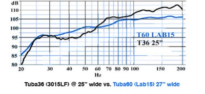

Okay - I had to go dig up my notes on this one....UROK wrote:You mean 4 x T36s what 30" wide to match how many of what model of T60?jcmbowman wrote:I did some pretty extensive comparison of the T36 vs. the T60 when it fist came out. I wanted to know what the fuss was about, and if it would be worth even considering making the switch. After poring over the response charts for a few hours I came to the conclusion that if the T36s are built wide (like I did), and you run a block of four at a time for most uses (like I do), then it's pretty much a toss up. The T60 is easier to move around, but it has a smaller horn mouth. The T36 can also be V-plated easily. And as far as pack space, they're just about even.
Here's as close of a comparison as I could manage. I'm using 30" wide T36s, so that dip is not as pronounced. Also, the roughness and the dip smooth out considerably once you start stacking them together, especially when you V-plate.
As a nice bonus, I get a really nice bump at 70hz, which is right where I usually add one anyway.
And I was incorrect above - the pack space is not comparable:
T60 @ 27" wide = 60" x 30" x 27" = 28.125 cubic feet
vs.
T36 @ 25" wide = 36" x 36" x 25" = 18.75 cubic feet
(And for reference, my T36s: T36 @ 30" wide = 36" x 36" x 30" = 22.5 cubic feet)

We are in agreement. It takes at least two, possibly four 30" 3015LF T36s to smooth the dip 30-70Hz. Gonna happen anyway in any correctly set up rig as you point out. That was what I meant. Not to denigrate T36s but suggest why they were made obsolete. The chart for a single 2Lab12 T60 tells us why. Nothing to do with practicalities even, just the scientific and engineering achievement is astounding.
