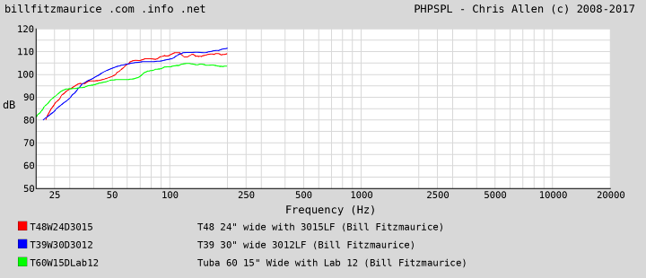

Once you have more T60s, will you be leaving-out the T48s? It SEEMS logical to just cross the T60s into DR280s at ~80hz, but you aren't the first one to employ subs with deep subs, using Bill's designs (WiSounds comes immediately to mind), so I'm curious why you'd choose to haul all of those "extra" cabs for the 50-100hz range. Don't misunderstand; I'm NOT, IN ANY WAY, saying "you shouldn't be doing that" ... I'm asking you to please attempt to explain the benefit of what you're doing.Dave Non-Zero wrote:1dual lab 12 t60 in the centre doing 25-60hz
6 t48 50-100hz
4 dr280 from 100hz up
2 dr250 on the top tipped up to hit the balcony. 100hz up
The t60 is another level. I love it. I am definitely making more. It just has an effortless authority and sounds more solid than any number of t48. It has a mouth 'blast zone' and tactile feel that I can't really reach with the t48.
Also, if a person were to design a 4-way system (deep sub / sub / mid / high), wouldn't T39s be a better choice for the subs (50-100hz)? If you increase the 15"w T60 in the chart below by 6db to approximate a dually, a 30"w T39 seems like a near-perfect match (and it's about 3 cu ft smaller than a 24"w T48).

Re: Wanted: T60 impressions and reviews
It was the dip, it was the dip!Dave Non-Zero wrote:There is a reason the t36 was made obsolete by the t60.
Need quite a few T36s to smooth it.
No more!
The chart for the dual T60 is awesome. Extension and sensitivity.
An amazing achievement when we are always talking about trade offs.
Again, Mr Fitzmaurice
Size does matter!
