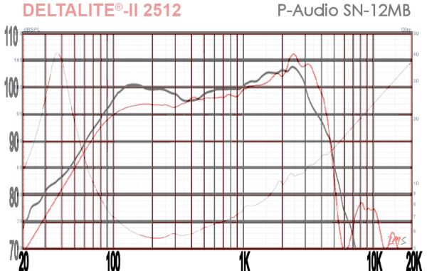

With that aside, these actually are now my OmniTops. I bought them from Stu a few years ago.
The SN12MB drivers are good if you get good ones, might even be slightly better in the low end compared to the 2512. Three out of the four in these are fine. One is not so great.
The scaling of the original P-Audio chart somewhat hides its' rising response. Scaled to match the 2512 chart you can see it rises very similarly, and is stronger in the low end.
