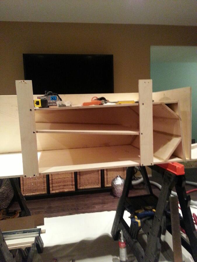

Staggered/offset from the braces on the opposite side of the panel is preferable. This will help in cutting down panel sympathetic resonance.

#32 Post by slinger »
How much about an inch or so.

#33 Post by Tom Smit »
Sure, that's fine.

#34 Post by slinger »
Thanks Tom. Are the braces just pl'd in place. I think there are going to be places I can't get a nail or screw in like between panel 4 and 7.

#35 Post by koturban »
Mine stayed put once I slid them in, but a brad or two will do just fine. Remember, the brads and screws are there to keep it in place while the glue sets.
Once the PL cures, they won't be moving.

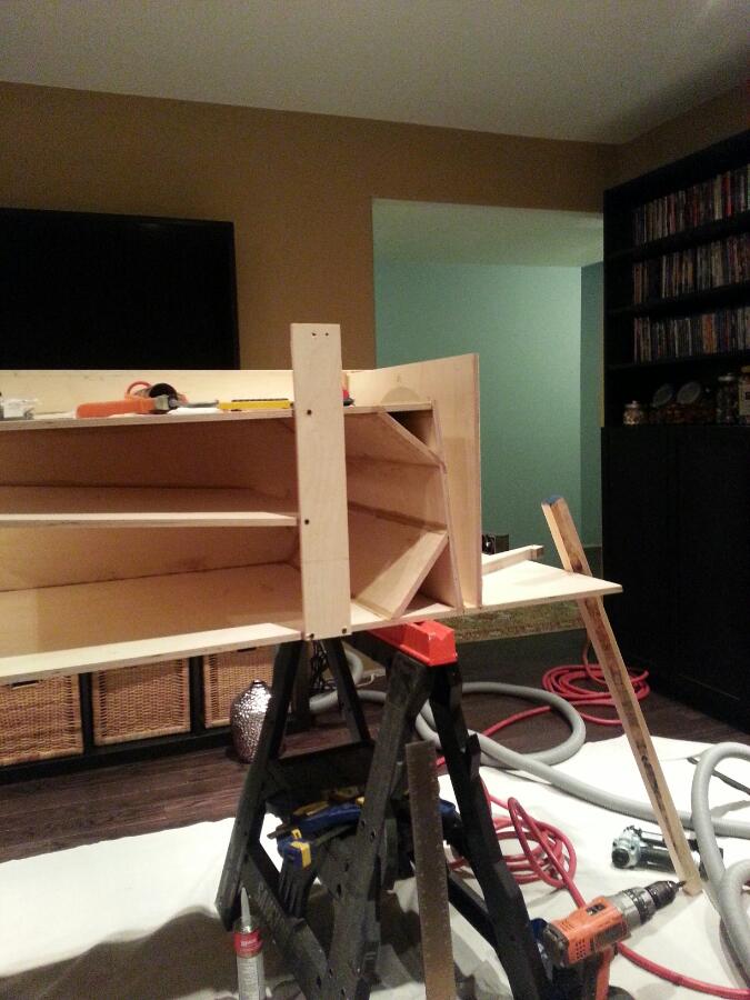

#36 Post by slinger »
Two more pics of panel 6 and 7.
