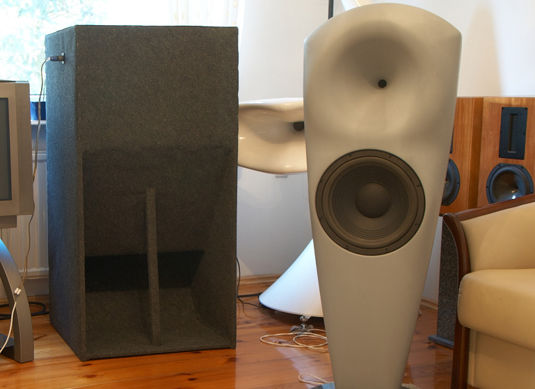

This is my Titan 48:
http://youtu.be/u73lNro99cY
driven with Beyma Power 15 and GDN-38-550-8-AE (Qt=0.9). Do you see air leaks on impedance plot?

No obvious air leaks, but a few resonances, probably from using OSB, which is not suitable for speaker cabinets.
Re: Titan 48 (OSB panel), Beyma Power15, GDN-38-550-8-AE
True - I wanted to have something light and quick on New Years Eve. 40Hz dip is too strong compared to your samples?

Not necessarily. I didn't test mine with that driver.jzagaja wrote:True - I wanted to have something light and quick on New Years Eve. 40Hz dip is too strong compared to your samples?
Simulation. Impedance of real speakers is shifted toward lower frequencies.

Ok. maybe not light but certainly a lot cheaper to experiment
- I wanted to see how my drivers behave.

I sealed internal walls and covered OSB with felt. Impedance has changed as you can see because I removed 6mH coil.

I disassembled my Beyma Power 15 from aperiodic enclosure (5 cu. ft), put in Titan48 and forgot remove low pass filter. In comparison to closed box bass is more felt on body but this is ca. 70Hz not 40-50Hz
We'll see on Monday. It vibrates quite a lot
