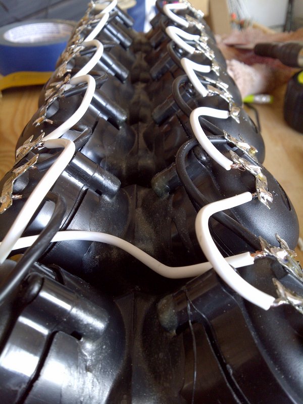

The way I figured it, the "In -" or ground connection is common to all in and out connections - in the center of the pic.
The 2 "In +" connections would actually be tied together since they get the same signal from the speaker jack.
Yes...?

Yep. Maybe he meant to invert the phase of the tweeter array? If you're going to do that, I would do it on the output of the crossover though. Especially since you tie your grounds together between the low and highpass filters.

The tweeter wire-up
The tweeter wire-up
