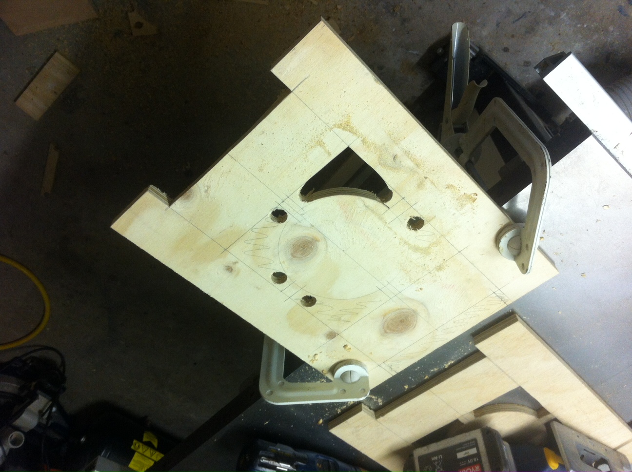

Well, they are pretty much complete, just need the mounts for the piezo array and the crossover to do. I'll still post the pics in order to pretend I'm still going but here's one with the wings on....
Just a shame I had cut the wings wrong and had to rip them off to put new ones on..... Grrrr.....

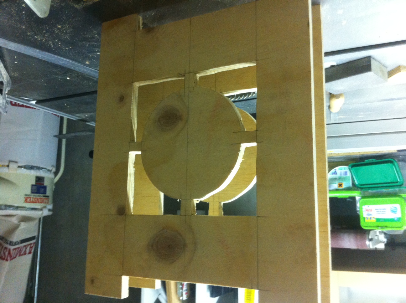

Re: Jack 110 x2
What the hell, here's a preview, I'll post the rest later.....
