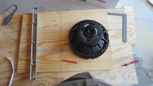

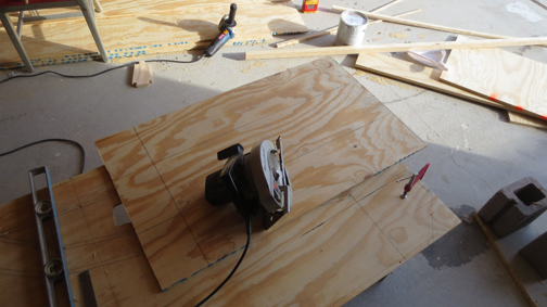

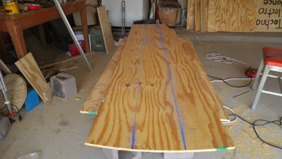

Changes for the fifth tuba. There was a sale on BC 1/2 plywood at Home Depot for $28, it green wood warped and only 4 ply but i love a challenge and this will be the tuba that will first experiment hopefully convincing us to upgrade the whole Fleet to 1/2 plywood.
:fruit:

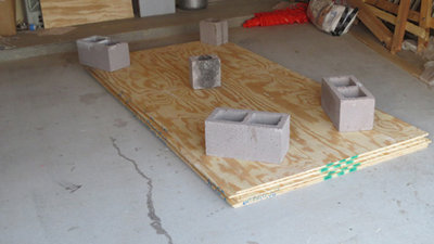

The green wood after two days drying under weight

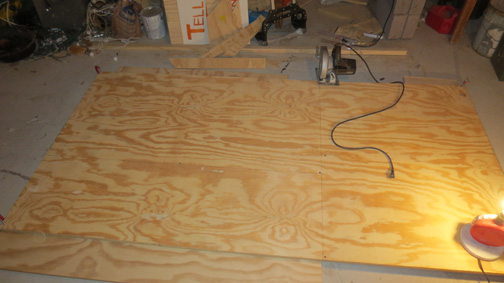

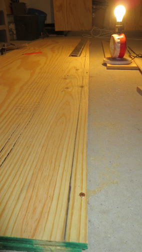

I believe that we are going to ude nothing but screws for clamps in this entire tuba.

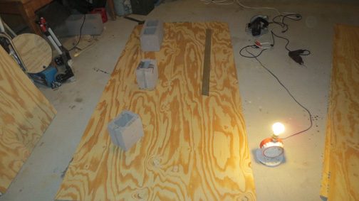

a level surface, lots of screws and weight are only way to prevent binding when cutting

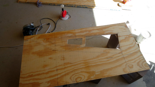

chalk line The easiest fastest way to get long straight lines
if anyone needs a chalk line but can't to buy-one can make one out of pulverized charcoal and cinnamon,

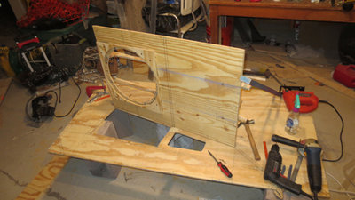

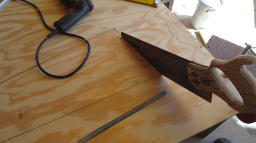

More of day one

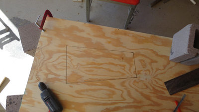

using the corners drilled with 1/16th drill bit to start off with until it's wide enough for the saws.

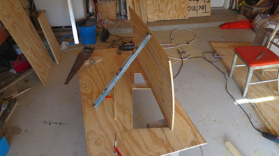

The result of using the miter saw and hacksaw to cut out the driver panel. Since i'm working with 1/2 inch wood, than the recessed steel flat bar of the other tubas will not work here. So it will follow the Plans to build internal sealing surface for the driver panel
I like the reduction in weight in just the side panel next to start getting the panels together

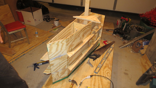

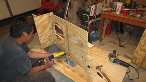

Day 2 and 3 was bust, my mom was admitted to the Hospital and i didn't feel much like building. SO on day 4 i was i need to build, Now this is where I break from plans due to the extreme warped nature of this Georgia Pacific plywood. planes 3-5 plus the braces are pre assembled to create 1/2 half the box around the driver, and panels 1-2 and braces are pre-assembled. since this is cheap play corner joints near the corners are reinforced with 3/4 ply
example of the wood were dealing with
Dry fitting panel 3 after cutting the 56 degree angle
Cutting marking panel 3 and pre drilling holes for the braces the already been sized to fit.
Measuring the driver hole and Driver spacer, I didn't realize how close the Driver needs to be to the end of the horn, so the other four tuba may be cutting themselves short because of the added 1/4 of an inch

I didn't realized it until after but its possible to glue 5 panels in one day, but I will post if this has any impact on the finish tuba.
Dry fitting panel 3 with driver spacer and tee nuts in
Panels 1 & 2 ready to be straightened.

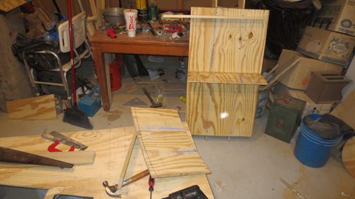

panels 1-3 get put in first then panels 2-5-4, you can see the little squares that reinforce the corner because this ply has a tendency to split. All hole are pre drilled

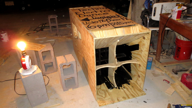

All five panels glued and screwed with braces, while the glue is still wet we place the tuba on the ground with weight on it

I dunno Between savings and time spend trying to straightening bend panels its a draw on using B/C 4ply pine but what i do love is the weight reduction. Almost 65 lbs less than the previous four tubas. So Follow the plans guys and girls. Save up for the 5 ply birch 1/2.
She's only 1/8 off on one corner
